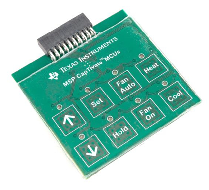

Product performance and functionality
The capacitive sensors coped well with all but the thickest of front panels I tested with. Even that one should be usable if the sensor pads on the PCB were larger. The sensors also coped well with the gloves and could adapt for different gloves without the need to change any settings. Because the sensor controller is also an MCU it's possible to build in other functionality into your panel such as the swipe direction indicators on the proximity demo. The proximity sensing was very good and it's nice that a pad can be both a proximity sensor and a capacitive sensor at the same time.
Designing your own board
TI do seem to give you everything you'd need here. The data sheet includes details of the minimal components you'd need to get an MCU operational, a handful of capacitors and a crystal for the oscillator. There are several reference designs including the evaluation kit itself. The code examples provided are clear to read and the Design Centre software provides a template to get started with your design.
One of the reference designs
Demo and Software
There seemed to be a few issues installing the software but even with me ignoring all the warnings that TI could throw at me, it still worked just fine. The different demo boards provided all worked and showcases the technology well. The software was easy to learn and use.
Support materials
There is extensive support material for this solution, from videos to reference designs to extensive documentation on how to design your sensor pad. The APIs provided in the software are also clearly documented with explanations and examples. There are also labs and workshops you can work through to understand the technology, I really can't fault TI in this category.
Example schematic
Price to performance ratio
The evaluation kit is quite expensive at £71.56 so I've marked TI down a little for that. The kit is excellently engineered and uses top quality components and connectors. Perhaps 3 different examples is overkill? Included in the kit price is the programmer which you could potentially use in your own projects. The kit should also mean your initial time to get a prototype up and running should be reduced.
TI's site suggests that the MCU devices should be around $0.5 however the device used in the evaluation kit is £ £4.14 on the UK site for Element14, which is about twice that of the ATMEGA328PB. Note that there could be cost savings compared to other products as you don't need to have a host MCU as well as a controller chip, which you'd need with the Cypress MBR3 technology.
Overall
The technology holds up well to the mock workshop environments I threw at it. The CapTIvate MCUs to have good range of functionality and you could easily use one of these along with the sensing technology to meet all of your front panel requirements and potentially more.
