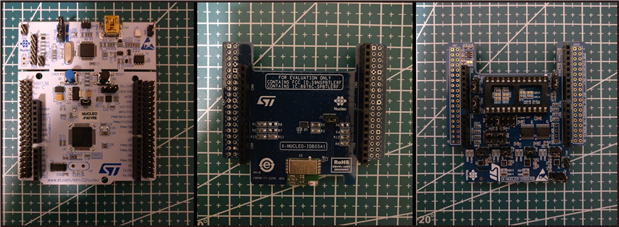

Boards I have received
The course materials were far from ready when I received my package from e14, but I can't wait to unbox and inspect them. From left to right, they are as follows:
  • Nucleo F401RE (STM32 Nucleo-64 dev board 84 MHz STM32F401RE MCU, 512 KB flash, 96 KB SRAM with Arduino pin compatibility)
  • X-NUCLEO-IKS01A2 (Motion MEMS and environmental sensor expansion board for STM32 Nucleo)
  • X-NUCLEO-IDB05A1 (Bluetooth Low Energy expansion board based on SPBTLE-RF module for STM32 Nucleo)
Image: Nucleo and the two expansion boards
Nucleo F401RE - Dev board
For a slightly aged board, Nucleo F401RE still packs quite a bit of grunt. Packing a Cortex-M4F (STM32F401RE MCU), the Nucleo F401RE is comparable to the Arduino Due, sharing the same amount of flash and SRAM - each packed full of MCU peripheral goodies. Nucleo F401RE takes the upper hand when it comes to geometric or signal filtering applications, as the Cortex-M4F comes with a separate floating point unit (FPU).
X-NUCLEO-IKS01A2 - Sensor expansion
The X-NUCLEO-IKS01A2 carries on board a combination of sensors:
  • LSM6DSL MEMS 3D accelerometer (±2/±4/±8/±16 g) and 3D gyroscope (±125/±245/±500/±1000/±2000 dps)
  • LSM303AGR MEMS 3D accelerometer (±2/±4/±8/±16 g) and MEMS3D magnetometer (±50 gauss)
  • LPS22HB MEMS pressure sensor, 260-1260 hPa absolute digital output barometer
  • HTS221: capacitive digital relative humidity and temperature
X-NUCLEO-IDB05A1 - Bluetooth expansion
The X-NUCLEO-IDB05A1 has a BLE4.2 compliant BlueNRG-MS RF module which supports connectivity through Bluetooth Low Energy.

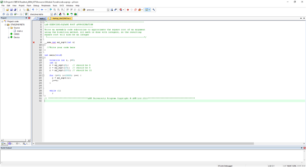

Lab 3: Square Root Approximation (Using Bisection method)
Lab 4: Digital Input/Output and GPIO (Press a button and see an LED light up)
Lab 5: Interrupt and Low Power Features (Same as 4, but now the MCU waits for pin interrupt in a low power mode)
Not much to say about the labs, as they are incredibly simple. All the boiler plate codes are written, so it's only a matter of filling up the missing codes. I can appreciate that, as it means more time devoted to the exercise problem itself. I find these lab modules useful for getting me up to speed with the debugging tool of the IDE (Integrated Development Interface) and also the CMSIS library that can be leveraged in application development. I enjoyed working with the assembly code implementation in Lab 3, as seeing it work helped validate my understanding of the Cortex-M registers.

Image: Lab 3: Insert missing code
Image: Lab 3: I wrote assembly!

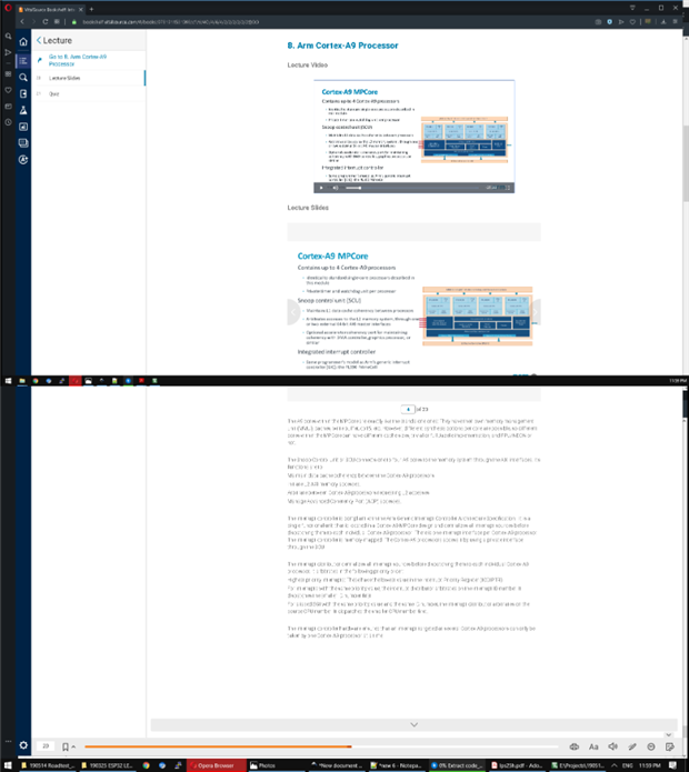

Module 8 covers the Cortex-A9 Processor architecture: Pipeline, multi-core processing, virtual registers, memory system, etc. Throughout the video, I kept wondering if these information is related to the lab exercises at all. I must say that after Module 8, I feel better equipped to answer the quiz back in the previous module. Maybe there was a mix-up some where. Below are some slides to give you an idea of what I was staring at.
Image: Module 8 Slide 4
Image: Module 8 Slide 7
Image: Module 8 Slide 13

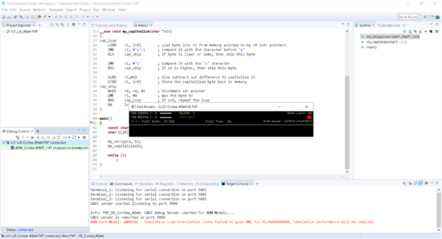

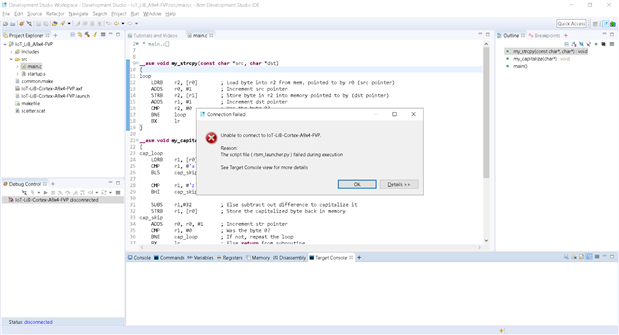

Lab 8: Migrating DS-5 projects to Arm Development Studio
We return to assembly programming in Lab 8, this time debugging an emulated Cortex-A9 processor using Arm Development Studio. No coding exercise here, just importing an existing project so that I can step through the disassembly. I hit an obstacle here as I wasn't unable to connect to the emulated processor. I did not foresee this gotcha, having followed every step along the way. I thought this might have been caused by a missing emulator on my system, as mentioned on Stackoverflow. I promptly went to sign up for an evaluation on Arm Fixed Virtual Platforms, which did me no good at all.
After raising this with other fellow road testers, I am told to switch to a different core, and it somehow worked, albeit with the warning: ARM Core Model: WARNING - Simulation code-translation cache failed to gain DMI for PC=0x00000004. Simulation performance will be reduced. It seemed to stopped working again at the time of writing this article - presumably because my evaluation period is over? I don't know. For all intents of the lab exercise, I was able to step through the instructions and see what happens to the registers during a function call (register use during argument passing, stack pointer, link register, etc.) So I'm more than happy to move to the next module.
In retrospect, I can see the value in this lab exercise, but unfortunately the time I have wasted troubleshooting has left me with an unsavory impression.
Image: Failed to run
Image: Successfully running. But I don't know why.

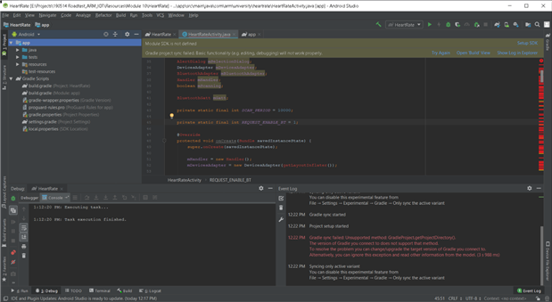

Lab 9: Designing a Basic Mobile Appcessory “Hello World!”
This exercise demonstrates how to create a basic app. Can't say much here, except that the demo was build on Android Studio 1.1.0. I have Android Studio 3.4.2 on my machine, and I wasn't able to run it. Basically the problem comes down to this message: "Gradle sync failed: Could not find com.android.tools.build:gradle:1.3.0." Changing it to '3.4.2' gave me this: "Gradle sync failed: Could not find com.android.tools.build:gradle:3.4.2." I have experience with Android app development, so I chalked it up to dodgy project files and moved on. I guess I won't be doing "Hello World" after all.
Image: Gradle sync failed: Could not find com.android.tools.build:gradle:1.3.0.
Image: Gradle sync failed: Could not find com.android.tools.build:gradle:3.4.2.

I tried to adapt to the VitalSource user interface, but it is just poorly suited as the delivery platform for this course. Here is my observation:
1) Layout:
When going through the lecture, I find myself choosing between watching the video or reading the transcript of each slides. If I want to see the video in full screen, I'll have to forgo the transcript. If I want the transcript, I'll have to minimise the video. This is the weirdest layout I have ever seen in an e-learning platform.
Image: This is what a regular lecture looks like.
2) Video playback:
There seems to be a caching issue with the video playback, as it reloads when I navigate to a different part of the video. Sometimes I need to go back a few minutes earlier in the video, or move the video ahead. Other times, I might pause and resume later. In any case, I would find my pace disrupted waiting for the reloads. Also, there is no playback speed setting, so I can't change the pace of the video lecture.
3) User interface:
To drive home the fact that this is the weirdest e-learning platform:
  • The only way to move to the next slide is to first minimise the current slide. Go figure.
  • The arrow keys left/right sends the browser off to load the previous/next module. When I return to my original page, I have to wait and reload the video again. Here's an idea: why not bind the arrow keys for navigating the slides, or the video. Or both.
4) Slow website:

4) Lab software license:
Lab exercises that cannot be completed because its code has exceeded the size limit has no educational merit. How about including trial licenses for the course participants? Alternatively, how about a free IDE? STM32 Cube IDE seems like a good candidate.
5) Gotchas and outdated project files:
The gotchas that I have faced in this course really rained spanners in my learning process. Too much of my time was wasted second-guessing if I have missed an instruction earlier or if it's just an error in the instructions. Then send me off on a wild goose chase, trying to fix the problems on my own. To be fair, some gotchas are bound to be discovered in a "new" course, but I do hope they get resolved for the future students. As for outdated project files, they should be checked to be working well with the latest software, or at least provide the software version, so that the students can better troubleshoot any problems that arise. No sense in providing outdated projects which are no longer supported by current versions.
