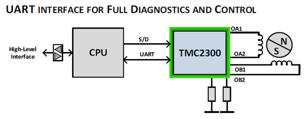

Two ways to control the motor:
  • UART mode, where you configure the driver and check diagnostics via a serial interface.
    Currents and all other available smart functions can be programmed.
    To move the motor, you can use the internal pulse generator
    In cases where it can't deliver the movement you need, you can provide externally generated step/dir signals (e.g.: BeagleBone PRU or microcontroller generated).

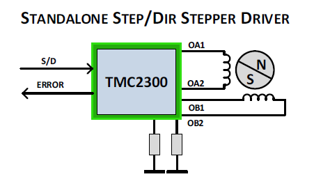

  • basic STEP/DIR interface. In this case the driver isn't programmed. Operation and standby current are configured with resistors.
    You have to provide the step and dir signals. The internal pulse generator can't be used in this mode.

My entire road test is based on using the UART mode, with the intelligent functions listed above.
Everything below describes operation in that mode.
The standalone STEP/DIR mode can be useful when moving from a legacy design.
When you put a few extra footprints for resistors and jumpers on your PCB you can switch between the two modes: making your design work first without touching the existing firmware. Then configure it into UART mode and adapt the firmare.
I wouldn't suggest this IC if you don't intend to use its UART interface in your final design. It's not intended to compete in the standard driver market and other ICs fill that particular gap better.
