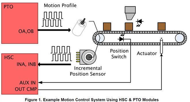

I have found an application note for the Hercules RM57: "TI Designs: High Availability Industrial High Speed Counter (HSC) / Pulse Train Output (PTO)".
An amazing document that shows how to control  production line belt using counters and pulses to check and drive it.
It's a great document if you're interested in autonomous timer co-processors. One of the best documents on that subject for the Hercules HET.

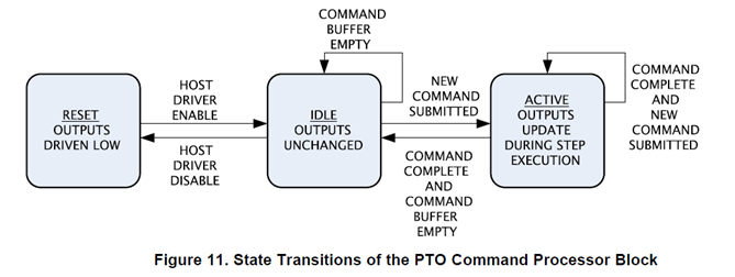

The HET is programmed as an autonomous state machine.
The only duty for the ARM core (called HOST DRIVER on the above state diagram) of the Hercules controller is to fill the command buffer with a profile:

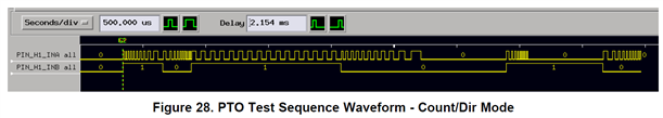

    ptoInit(pto1, ptoModeCountDir);
    ptoCmdCreate(&cmdList[0], 1000000, 50, ptoDirRev, ptoAccLinAcc);
 ptoCmdCreate&cmdList[1  105132 10 ptoDirRev ptoAccZero
 ptoCmdCreate&cmdList[2  105132 50 ptoDirRev ptoAccLinDec
    ptoStart(pto1);
    for (i = 0; i < NUMCMD; i++) {
        ptoCmdSubmit(pto1, cmdList[i]);
* ptoRetVal_t ptoCmdCreate(ptoCmd_t *cmd, uint32_t icnt, uint32_t nstp, ptoDir_t dir, ptoAcc_t acc);
* - icnt = initial pulse width (in counts of N2HET High Resolution Clocks
* - nstp = number of steps to execute in the command
* - dir = direction of steps (forward, reverse, or pure time delay)
* - acc = acceleration type (accelerate, decelerate, or zero acceleration/constant speed)
HET will first pulse out a train of 50 pulses, with the pulse width 1 000 000 times the period of NHET clock as start period:

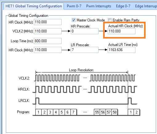

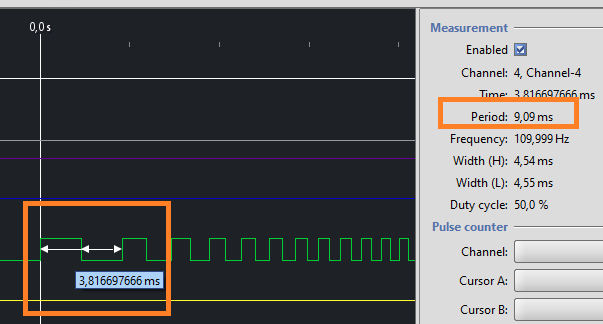

If I count correctly, 1 / 110 MHz * 1 000 000 = 9.090909.... ms. Let's check on a capture of the sequence above with the logic analyzer:
Spot on!.

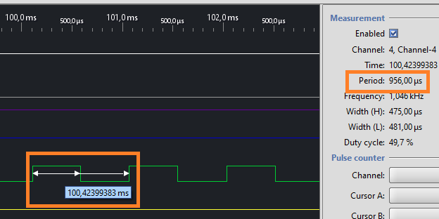

Then 10 steps at the stable speed of 1 110 MHz  105132105132 956 s
Again correct.

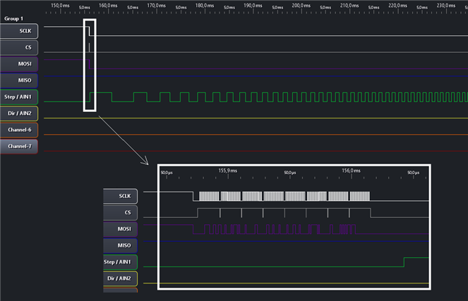

Here's a capture of the SPI initialisation (expanded in the inset below right) and the pulse train from start to stable.
If you have OpenLogic Sniffer software, you can review the measurements. I've attached the .olp project. It contains all sample info.
In the sample resolution that I used, my logic analyser (a Papilio Pro FPGA board!) doesn't have enough memory to catch the full pulse train and all HET information in one shot.
Here's a capture, at slower sampling speed, of the pulse train only (click for higher image resolution):

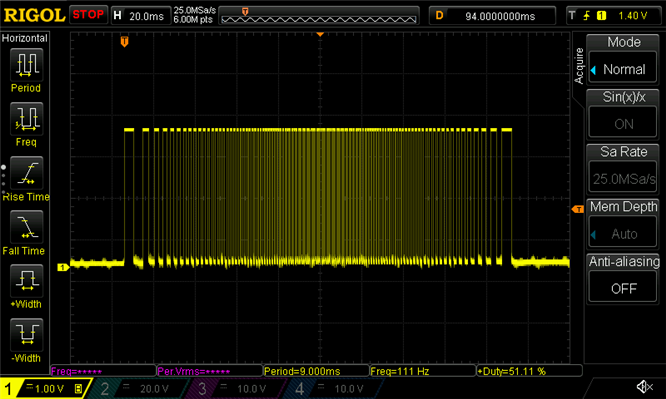

On an oscilloscope:

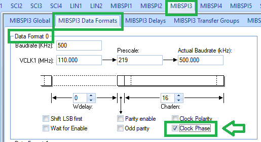

I assumed that my motor would start spinning, now that I have replicated SPI sequence and pulse train - and drive the nSLEEP pin correctly.
But it doesn't. I'm going to rewire the original MSP430 setup and see if I miss something.
Hang on....
edit: the reason why it wasn't working was because of the SPI settings.
I had to change the clock phase. That changes at what time the data is written (and read) relative to the clock signal.
