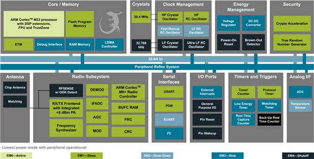

To understand which peripherals are active under which power management mode it is worth looking at the above block diagram, which can be found in the datasheets for the BGM220P modules and the EFR32BG22 SoC. So, for example, USART and PDM only operated in EM0 (Active) and EM1 (sleep) modes while ADC and I2C will continue to operate up to EM3 (Stop) mode.
What is somewhat confusing with this diagram is that not all GPIO’s will operate down to EM4 levels. This is port dependent (please refer to the EFR32BG22 data sheet for more info). So, GPIO's via Port C do not operate at the lowest power management mode while GPIO's via Ports A and B do.
It is also worth noting that within the BGM220 product family there are two variants, which have distinctive differences (highlighted in bold):

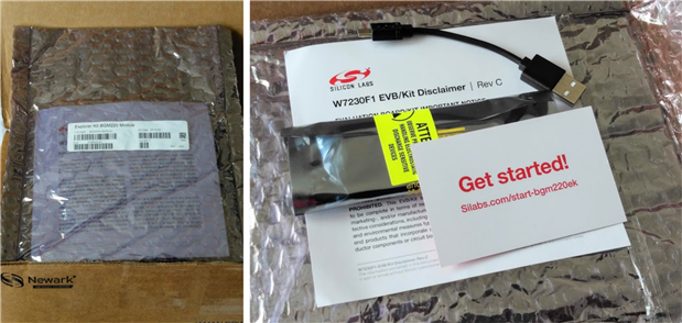

Unboxing Experience
The unboxing experience is a little underwhelming, in my opinion.
I did not like the use of the clear bubble envelope, as I felt this was far too generic and lacked impact. For example, using a coloured padded/bubble envelope would’ve delivered more impact at a similar price if a branded padded/bubble envelope was too pricey (a quick search on Amazon.com and I found 50 x 4x8 inch black envelopes for $7 - at volume this would certainly be cheaper still).
Opening up the clear bubble envelope you’ll find your Explorer Kit inside an anti-static bag, a very short (4.5”) USB cable, a disclaimer leaflet and a “Get started!” business card.
Personally, I rather liked the business card. This is just the starting, or onboarding, process I'm looking for.

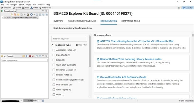

We all have to start somewhere. This tends to start by first connecting the BGM220 board to your computer's Serial COM port with the USB cable. At least this connection process is very straightforward as Simplicity Studio 5 instantly recognises your board once connected. All you then have to do is hit the "Start" button.
This then opens up an overview page for your board. Here you are presented with a few quick start guides and you can view some documentation for both the BGM220 Explorer Kit and the EFR32BG22 SoC. However, this is not all the documentation available. There is also a separate "Documentation" tab available, which presents you with a more comprehensive set of documentation. This is quite a handy local reference (as does not require an Internet connection). However, I myself tended to rely on my web browser and search the silicon labs website as Simplicity Studio's "Filter on Keywords" option did not work very well for me as all the keywords I came up with returned zero results.
Clearly there is plenty of documentation available - e.g. 42 Application Notes and 20 User's Guides etc. That is a lot a reading to get through when starting out and I am not really the reading type. I prefer to learn by doing and so I gravitated towards the "Example Projects & Demos" tab.
The examples and demos are split into 3 "Technology Types". I focused on the two key types to get me started.

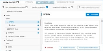

Before diving into some of these examples, let me just say that what I really like about all these examples is the use of standardised templates for main.c and app.h/app.c. This really helped me when trying to understand the mechanics of the examples, especially when little to no detail is provided about program architecture, flow and algorithms in the example documentation.
The first 4 platform examples are very straightforward and very quick to implement. They work straight out the box. This seemed to be a logical place to start. However, beyond these four examples there appears to be no logical order (from a learning perspective) in how the examples are organised other than being in alphabetical order.
So, I jumped to the “Simple Button Bare-metal” example as this example project shows how to toggle LEDs using buttons in a bare-metal environment. Seemed easy enough to try out, or so I thought. Without proper example documentation, it caught me out and I had to spend a good deal of time, and get a bit of help from Silicon Labs excellent technical support, when trying to make sense of what was going on. The answer of course was buried in the technical detail. The user button (BTN0) on the Explorer Kit is tied to Port C, which does not work at the EM2 power management level. This is explained in the application note AN0918.2 (section 6.5) and in the EFR32xG22 reference manual - Section 25.3.6 EM2 Functionality.
So in order to get the “Simple Button Bare-metal” example to work you either have to change the GPIO pin and use a PA or PB pin, or you remove the Power Management component, which disables the sleep function.

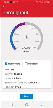

The throughput sample application allows you to measure the data throughput between an EFR32 device, like the BGM220P module, and another EFR32 device or a smartphone running the EFR Connect mobile app. However, the documentation fails to explain how to change any of the parameters that can affect the throughput results. No doubt some will look at the results achieved using the example's default parameters and wonder why they are getting significantly lower results than demonstrated in the animated GIF image in the documentation or as shown above in app screenshot.
In my case, my phone had something to do with it. My Android OS phone only has Bluetooth 4.2 and this does not provide a 2M PHY mode. Thankfully, my son's Samsung phone had Bluetooth 5.0 and this did allow for a 2M PHY mode.
This helped improve throughput but it still did not give the optimum results. After further searching online, I discovered this helpful guide that enabled me to understand and resolve the issues: https://docs.silabs.com/bluetooth/latest/general/system-and-performance/throughput-with-bluetooth-low-energy-technology

But first we need to define our drivers and GPIO pins within Simplicity Studio.
This is really straightforward and very quick, when using the Software Components GUI tool.
First we create our SPI driver instance using the default mikroe instance name.
The default config settings are just fine.
It is a pity though, that you cannot disable the MISO (RX) pin using this tool, as it is not required. If you try set this to “None” you get this error:
Then we define our GPIO pins. Here I used the Platform > Peripheral > GPIO Init option.
This creates all our setup files.

    1. Which project have you started with Example Code(Empty C, SPI Bare Metal) or imported files.
    You can start with any project. As I like to have serial output for debugging, I tend to start with a project which has UART serial output enabled. I added the SPI component myself, so it's not necessary to start with SPI Bare Metal.
    2. While Adding SPIDRV, default instance name was not mikroe. So I do it myself.
    I suspect Simplicity Studio has been updated since I did that project. I may even be related to a newer version of the BLE Explorer Kit or maybe a different dev board. Not serious. Just use whatever the default is or create your own.
    3. "Next step was to create my example application code, which would incorporate an init function and my “ticking” function: spidrv_app_process_action()" I do not follow how you added this file.
    Yes, not sure myself. I am assuming it is called elsewhere. It is probably linked to the SPI Driver API.
    edited : In this given sample code : some function used on different library such as Paint_DrawPoint, Paint_DrawLine etc while its library (GUI_Paint.h) not included.
    You can find it here: github.com/.../GUI
    4. "#include <spidrv_waveshareepd.h>" how to get this Library?
    This is a custom interface library I created so that waveshare epd and Simplicity Studio spi drivers would work - I no longer have a copy of it. I remember it is quick to make yourself.
  • I was following your project to drive e-paper display with thunderboard. I have few doubts, I just started working on SSv5 so if you can help please take a look:
