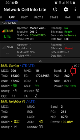

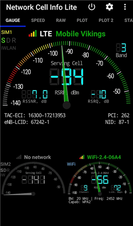

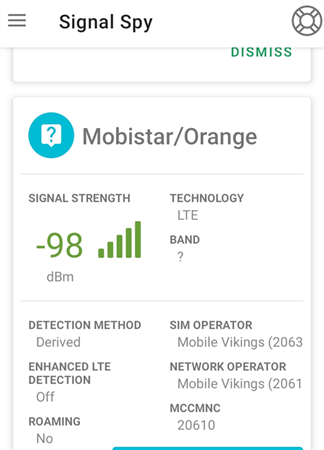

For proof-of-concepts, standard mobile phone SIM cards work too. But it may be hard to get info. They rely on the phone OS to set everything correctly.
I used two smart phone apps, Network Cell Info Lite and Signal Spy to spoof the necessary connection info. You put the SIM card in a smart phone and execute the apps.
They reveal a wealth of information. Here are a few captures from when I tried to get as much info from a Mobile Vikings connection as I could get.
