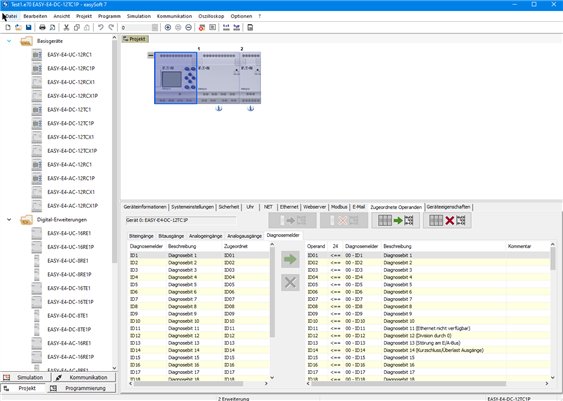

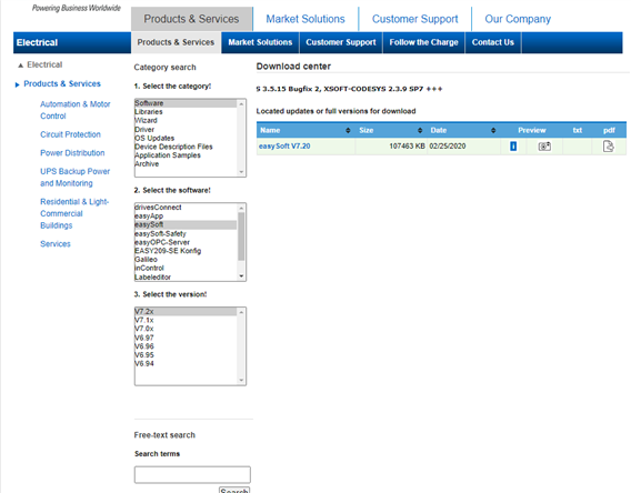

    geralds over 6 years ago in reply to rscasny
    Hi Randall rscasny ,
    The latest Easy Software you can download here. The latest version is EasySoft V7.20.
    Eaton Products & Services - Eaton Europe
    Also for the units, the basic and expansion modules as well you can download the latest firmware here:
    For example the license for the software, also the software are included in the Easy-Startup-Box e.g. EASY-BOX-E4-UC1
    https://uk.farnell.com/eaton-moeller/easy-box-e4-uc1/software-starter-kit-8i-p-4o-p/dp/3371914?st=easy%20e4
