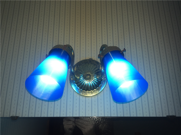

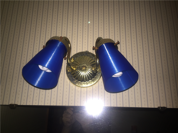

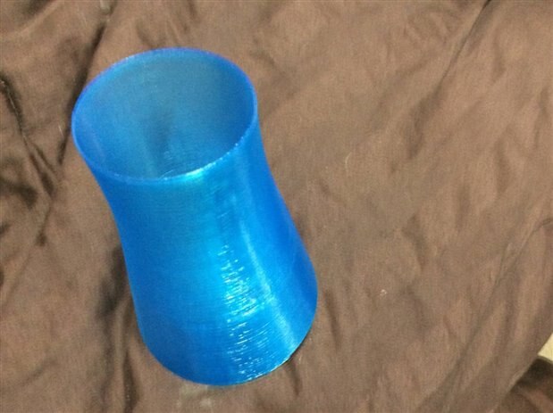

My newest design and print. 50 mm diameter 125 mm height. 1.5mm PLA blue transparent. Bottle neck ridge for support in the base. It still has a seam, I tested spiral and the walls are too thin and could not print the bottle neck, it tried to hollow it. .4 mm nozzle and to thicken the walls one would have to increase the nozzle size with spiral slic3r.

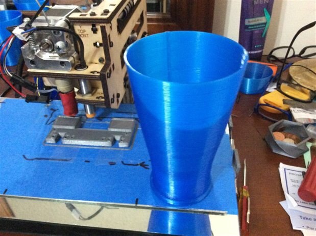

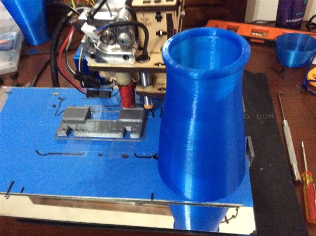

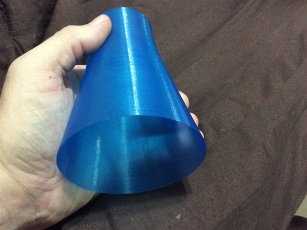

    Spiral test with no seam in Slic3r. 1 layer, one bead of filament in a spiral print.
