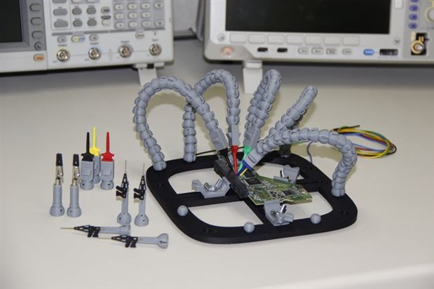

As this is the first time I write on these pages, let me shortly introduce myself:
My name is Giuseppe Finizia, I'm an electronic engineer and I work in the Scientific Investigations Department of the Carabinieri (italian police). In particular, I am the senior analyst of the Electronic Forensics Unit of Carabinieri and I deal with technical investigations on seized electronic devices. So I spend almost all the day in a well equipped electronic laboratory. However, very often I felt the need of a tool on which I could place a printed circuit board to perform technical assessments, such as acquire data from a circuit memory, or analyze an I2C or SPI communication bus using a logic state analyzer, and much more. In all these cases, until now I had to use the usual "third hand" tool, but then I decided to create a specific tool for my needs. So I designed this "PCB Workstation with Articulated Arms", with which I can now connect the lab instruments to the individual electronic components to be analyzed.
So, I wish to share with the element14 community this 3D printed project:
http://www.thingiver...om/thing:801279
Although there are many good free 3D modeling software, for this project I used "MOI 3D" (www.moi3d.com) because it is very powerful and easy to use.
Printing all the parts could be a challenging task using a not adeguate 3D printer. I have used my ZORTRAX M200 which is a very accurate and high resolution 3D printer.
Anyway, I have just updated the thingiverse.com page of my project by providing detailed instructions for 3D printing, so you can get there more details about this benchtop tool.

    Hi Guiseppe, Thanks for sharing your invention design. I have wished for something like this every time I have had to probe a circuit board in more than two places at the same time. John

    JUST UPDATED!! Look at the new parts and accessories! See new pictures and instructions page: http://www.thingiverse.com/thing:801279

    It is really quite a great tool. I do not know of anything  else that is available to probe this many points of a circuit at the same time. Are you going to market it?
  • giufini71
    giufini71 over 11 years ago in reply to jw0752
    Hi John, I prefer to let my "PCB Workstation" freely available to the public and I don't want a commercial distribution of this tool because I wish to incentivate the use of 3D printers to produce our own tools when needed.
