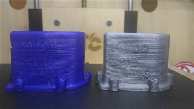

Hi I'm having some troubles with the alignment in the x-axis
i tried:
swamping axis motors -Same result
checked the heat bed level -Same result
Reset factory settings -Same result
and also checked axis belt and it looks fine with good tension (but I never changed and I have my printer for almost 2 years)
(and Im just ordered a new belt)
do you have any thoughts on the problem?
Also I attached some pictures of the model and the result
thanks for the help

    Michael has some great points.  I would also check your acceleration.  To fast will also cause misalignment.  It seems like the shift is consistent in one direction which would make me think there is some printer alignment issue.   Check to see that all the axis are square and that the grub screws on the pulleys are tight.  Do all the axis move freely and without a bind point.  When you swapped the motors did the shift go in the opposite direction?  Did this start to occur after a software or firmware update?  Does the electronics get hot?

    and even if the model is rotated the alignment issue stays in the x-axis (at first I was thinking that it seems as an accumulative error because there is no gaps)

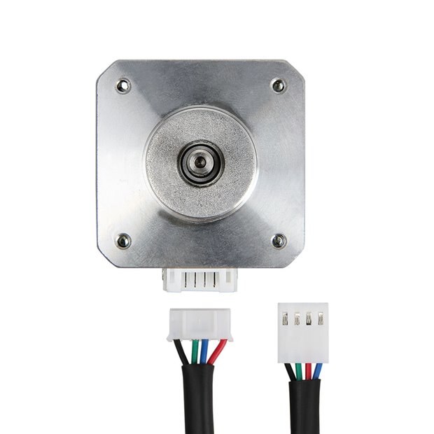

    I see you said you swapped the motors did you also swap the stepper drivers?
    Yes - and the misalignment keeps in X axis
    Have you tried adjusting the current on the steppers?
    I don't know how to check it, but I presume that is in default setting
    Have you checked to make sure the x-axis moves freely?
    Yes - the cart can jog all the way through X axis
    I just change the belt with no good result
    the next thing you want to try is to change the motor cable, even though the cable has continuity can be broken filaments, which can cause current problems
    do you know what are the part number for the connectors?image

    0 e14 Contributor over 10 years ago in reply to Nate1616
    I'm afraid that this link is for the Sensor swich cable not for the Motor cable
    I'm locking for a brand new makerbot replicator Motor cable or to find parts to make one or
    as last resource refurbish my "faulty" cable
    Hi there I just made and change the motor cable and it worked very fine
    thanks for the help imageimage
