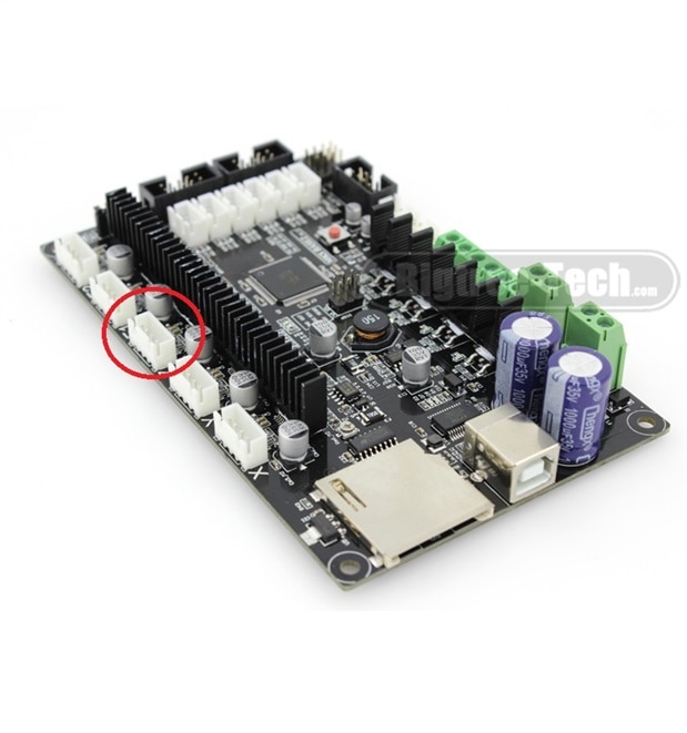

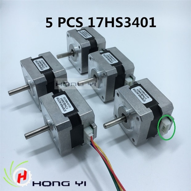

hi,
I´m designing a 3d printer and I need a reference of conection of nema17 6pins and a reference of conections of Base2 MKS.
Thanks

  • ielorriaga
    0 ielorriaga over 9 years ago in reply to rachaelp
    Hi,
    I need the conector marked reference to put in cable one to conect with nema17 and in other side to conect with Base2 MKS.
    Thanks,
  • rachaelp
    0 rachaelp over 9 years ago in reply to ielorriaga
    So you don't need to know the pinout, you just need to know what type of connectors to buy to plug into the board and steppers?
  • ielorriaga
    That´s right
  • rachaelp
    Have you looked here? http://reprap.org/wiki/Stepper_wiring
    On that page they recommend some JST parts. Please double check the specs for the following parts to ensure they match the motors and boards you have before ordering as I haven't used these motors or that board myself so am going from what I can find with quick searches.
    This would be the 6 way housing: http://www.digikey.co.uk/product-detail/en/jst-sales-america-inc/PHR-6/455-1162-ND/608604
    This would be the 4 way housing: http://www.digikey.co.uk/product-detail/en/jst-sales-america-inc/PHR-4/455-1164-ND/608606
    The pins for these connectors would be: http://www.digikey.co.uk/products/en?keywords=455-2148-1-ND
    Best Regards,
    Rachael
