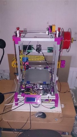

    I have been tinkering with 3D printing for quite some time and have experimented with various designs delta,cube and prusa style. I have found the whole experience very enjoyable and I have learnt a lot in the process. I started off with a Mendel kit from Reprappro (alas no more) but used that the make the parts for other designs. My current tinkering is this:-
    It may look quite complicated and a bit messy as it has evolved over a long period of time. Recently I have been experimenting with a belt driven Z axis which is counter balanced - it works really well.
    There's a raspberry pi in there too.
    I agree with balearicdynamics 250 - 400 USD should get you a good starting point.

    Thanks bwelsby
    That looks like quite an impressive machine. image
    I am taken with the idea of 3D printing parts to improve the machine, and build bigger and better models. Unfortunately it's a bit of a chicken/egg situation at the moment.
    The Mendel looks like a very different animal to your current printer.

    I love your monument to progress(ive) 3D printer building !!! It's really nice. A curiosity: what is the Pi used for ?

    Thanks, I have gained more enjoyment from tinkering with the designs than just printing useful items.  The current design is more like the Mendel than it looks, the X and Y axes are almost identical, the main change is the framework, I have used 20x20 extrusions and the belt driven Z axis replacing dual stepper motors and lead screws.  I am now using E3D hot end and extruder and can easily change it to dual too.
    The electronics is arduino due + RADDS   and current software is Repetier Firmware on the RADDS,  Repetier Server on the RPi.

    Certainly a tinkering project in itself. image
    Please tell me you printed the yellow flexible cableway...

    Thanks , yes it is a bit of a monument, I wanted a decent Z dimension - 300mm also I made use of existing 20x20 rails that I had used on a delta design.
    Initially I ran OctoPi  on the RPi but then switched to Repetier Server which I prefer, the full version is a little expensive in comparison but I got a big discount for early users image
    I have the RPi camera too but that isn't on the photo, been using the camera in other experiments.

    Yes indeed, anything that has some colour I printed.  I use a very cheap PLA for prototyping and then if needed for better structural strength or temperature tolerance I have used Colorfabb ngen or PETG.
