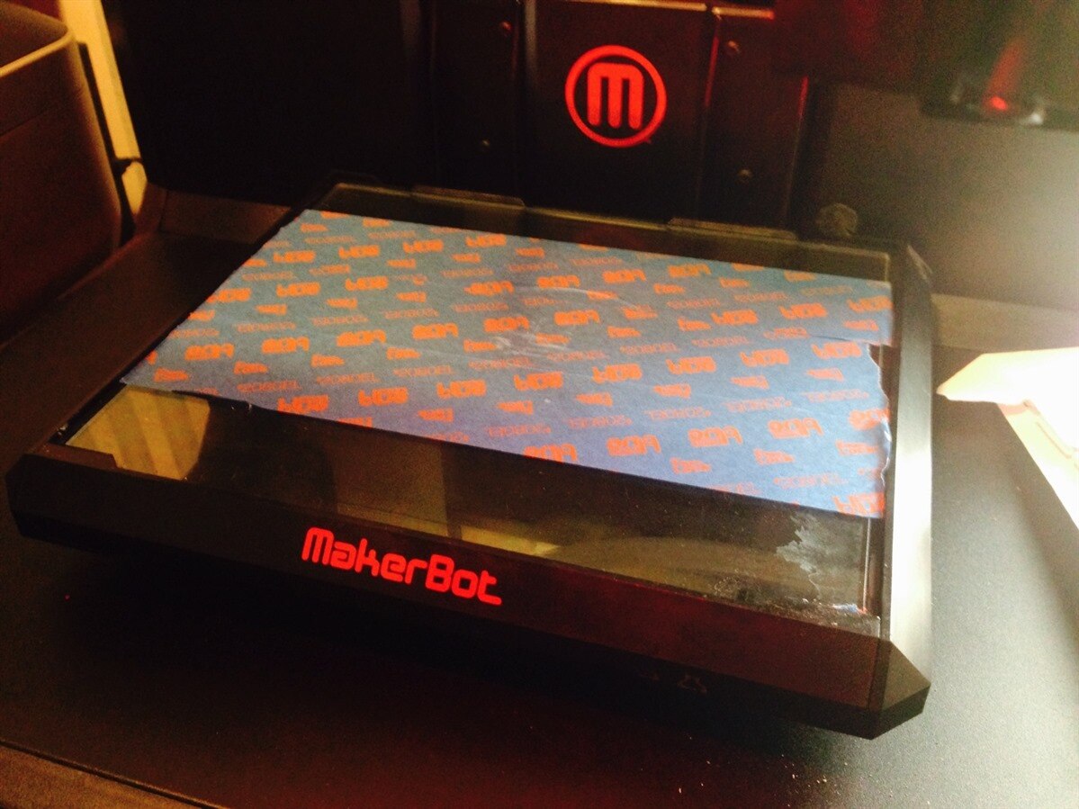

Hello,
I am a proud owner of a MakerBot 5th Gen 3D printer. I love it and it prints great using PLA. It makes excellent rafts! image I am starting to experiment with printer settings (temperature, speed, layer height) just to see for myself what happens in my environment. I am curious to see if I can print without a raft or blue painter tape directly on the glass. (very smooth surfaces when attempted) I have used hairspray which works great at first but as the lower layers cool (even when using rafts), they will eventually come free prior to the print completing. I have checked other printers and I see ultimaker has a heated glass bed which looks really cool. (no pun intended) But what to do with MakerBot?
I am living in New England and February 2015 has been wonderful for travel agents. A few days ago, as I turned on the rear window defrost, I wondered, gee could a 'defroster' be added to the glass bed of a makerbot? It doesn't have to be hot, just warm.
So here is my question to the group: Are there "off the shelf" methods or hacks to add 'lines' to heat a standard (non tempered) glass bed found on a MakerBot 5th gen?
Just curious. I would imagine Ben may have already thought of this and possibly made the hack. My hope is that it is a simple hack consisting of painting conductive paint on the glass and attaching some low voltage to it.
Any feedback welcome.
Thanks,
Vince

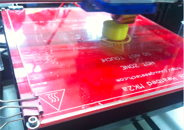

    e14 Contributor over 11 years ago +1 verified
    Is the heated glass bed like this?

    0 e14 Contributor over 11 years ago

    0 vd0gg1t over 11 years ago in reply to e14 Contributor
    I wish. Is that a 5th Gen? My 5th Gen looks like this: (I am checking with MakerBot support if a 5th Gen Heated Bed is even an option)
    I see what you mean. I will check the specs and see what I can sacrifice.image Thanks!
