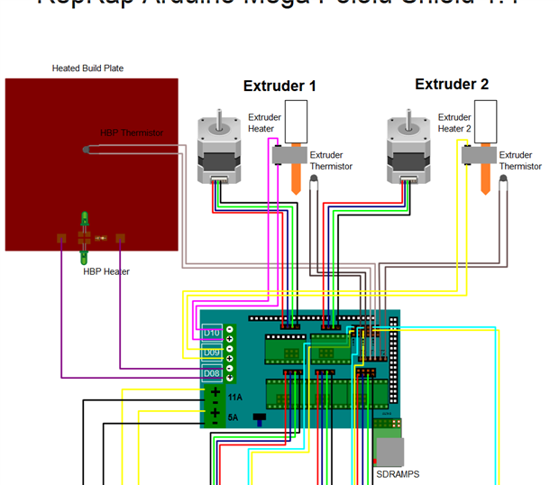

I recently started researching into making my own 3D printer (which I might do or I might not) but does the stepper motor which feeds the filament into the hot head need it's own A4988 driver? I'm planning to control it using the Arduino Mega and the RAMPS 1.4 board if that helps and is there any thing else I need to use/know before I decide to go ahead on this project?

    Kristaps-
    Yes, you will need a stepper driver for the extruder.  The typical setup is a driver for each axis(x,y,z) and one for the extruder.  The z driver will drive 2 motors in the typical Cartesian style printer.  The Mega 2560/RAMPS 1.4 is a great setup.  One thing you might want to look at is the newer electronics that are using faster processors.  This is going to be the year in 3d printing that will make 8bit controllers a dying technology.  The smoothie board is a nice 32bit board.  I'm also starting to look at the BeagleBone Black and CRAMPS board but haven't had much time with it yet.  They are currently working on a updated version that is suppose to have support for the Edison.  If you have any more questions don't hesitate to ask.

    No you don't have to have 2 motors for the z-axis but caution you that having a heavy carriage will cause the motors to skip/miss steps.  What you might want to look at is converting the standard Wade's extruder (direct drive) to the Bowden.  This will lighten up the carriage as the bowden extruder moved the motor off the carriage.
    As far as the temp sensor goes the typical thermistors used on extruders will allow you to go above 160C.  For example this is a common thermistor. http://media.digikey.com/pdf/Data%20Sheets/Honeywell%20Sensing%20&%20Control%20PDFs/135-104LAG-J01.pdf

    0 Nate1616 over 11 years ago in reply to e14 Contributor
    Here is the standard hookup of the thermistor(temp measure).  No extra board is needed.
