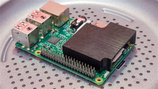

    Point 1 - I think this is still ambiguous as to my eye it looks less than 6.
    I've sketched in the 8 and the 6 boxes which shows the right vertical edge of the diagonal plane doesn't line up with a projection of the 6.
    Point 2 - you don't need the centre of the arc but you would need to know the placement of the two lines it joins. Currently I don't appear to have that information without knowing the angle of intersection of the two duct channels as Shabaz later points out.
    Point 3 - I still only see a measurement on one axis there. As with point 1 it looks a bit ambiguous.
    Out of curiosity I was in the process of creating a 3D model of the same part to generate an isometric view from 3D to see how it line up with  Shabaz' 2D drawing...
    I got this far in about 5mins:

    Hi Shabaz,
    Yes the angle 'x degrees' would work for me image
    The base thickness is a little ambiguous in my opinion as there is nothing to say that the upper and lower walls of the duct are actually the same height.
    The fillet radii are fine as long as we know the angle of the intersection of the duct. CAD as you say will do it automatically. In Vectorworks for example you can just select the two lines and specify the radius and the fillet is inserted in-between them.

    I too am curious what 3D software you used [edit: I see you've mentioned it].. It is an irritatingly complex shape to hand-sketch, ordinarily stuff is far easier - it is a duct for the Pi 3, it sits on the Pi (but is thin enough not to obstruct things plugged on top of the Pi) to allow airflow from a tiny side-facing fan to cool it. It would still need some funnel-shaped end attachment to clip onto the selected fan.
