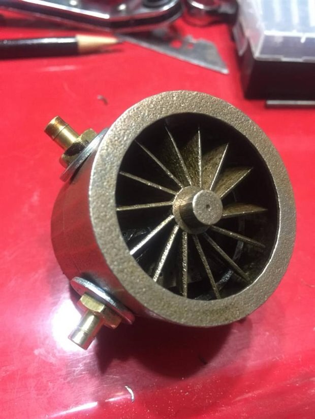

3D Printed Turbine
bradnorwood
bradnorwood over 9 years ago
https://youtu.be/4tB3WrXRBEw
Needs more compression and less fuel.

    ajens23 over 9 years ago
    Hi Brad,
    Nice turbine,
    but your tip clearance looks excessive and you blades need more pitch.
    What are you trying to do with it?  Is it just a cool demonstration piece or is it part of a larger plan?
    Al
  • bradnorwood
    bradnorwood over 9 years ago in reply to ajens23
    I'm happy with the pitch for now. I've had it up,to 7000 rpms off air. I can test the rpms with fuel because it needs a regulato. I've redesigned it a little and waiting for the new parts. I have a dozen projects for it.
