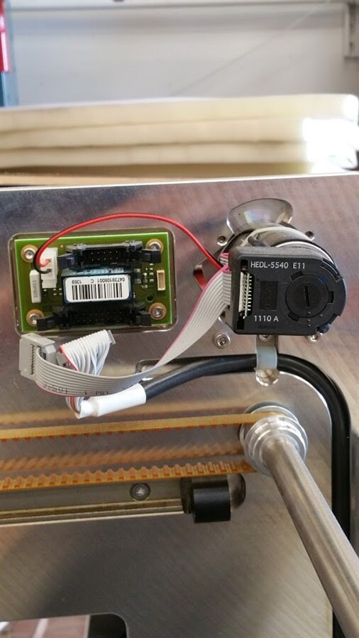

can anyone point me in the right direction?
I recently picked up a nice biotech xyz table.
I've confirmed that the components themselves work but want to convert it into a CNC router / 3D printer.
The table uses med size DC servo motors for all movement and has the original PSU.
I have looked all over and have yet to find an arduino based solution for a servo CNC

    currently it is just a 3 axis table that uses dc motors with attached encoders.
    the motors are 24v DC
    the encoders are 5v, optical, three channel units with a resolution of 1024 counts per revolution at up to 30,000rpm
    I have a PSU that will provide both
    I also have L298N and A4988 drivers on hand.
    For control I have Mega and Uno arduinos.
    I want to be able to send the arduino a g-code file and have the table follow the path, once I get to that point, I can decide on what form I want the machine to take.
    I'm pretty good with electronics and mechanics, if it were a stepper system I could figure it out, but I'm not very knowledgeable with the programing side of things.
    also I don't know if it is important, but the small pcb next to each motor shunts the motor and acts like a braking mechanism.

    Basically I have a very nice bare machine, it was in the medical industry so high precision parts all around, one of the heads had a needle attachment that touched various areas of a tiny glass microplate, so as far as accuracy and repeatability, i'm not worried.
    all i'm asking for is to be pointed in the right direction.
    the original controller (not working and proprietary)  was a Marvell ARMADA 162, it ran at 400mhz but also had to deal with at least 10 servos, along with 3 or 4 stepper motors solenoids and a bunch of temp and pH sensors.
    like I initially said, i'm just wanting a push in the right direction, not reasons why it can't be done.
    So ok. so far, the general idea is an arduino running at 16mhz controlling 2+ pwm channels and reading 6+ digital position channels will run into resource issues.
    How about breaking it into smaller pieces, Use something like an Attiny85 for each encoder, basically set up a simple protocol where it only receives 2 digital signals and translates those into a specific distance and direction, that way existing arduino stepper motor CNC sketches will be usable.

    Generally speaking the processors you are talking about are not the first (or second or third) choice for linear motor control.
    TI make suitable processors and low cost dev  boards and also publish a lot of good information about motor control. You might do well to look at this and it would at least give you some ideas.
    Enrico is right in pointing out that it will be more difficult to control a 3 axis machine based on servo motors.
    Of course there are advantages as well - all the commercial CNC metal cutting machines I know of use linear or BLDC servo motors.
    MK
