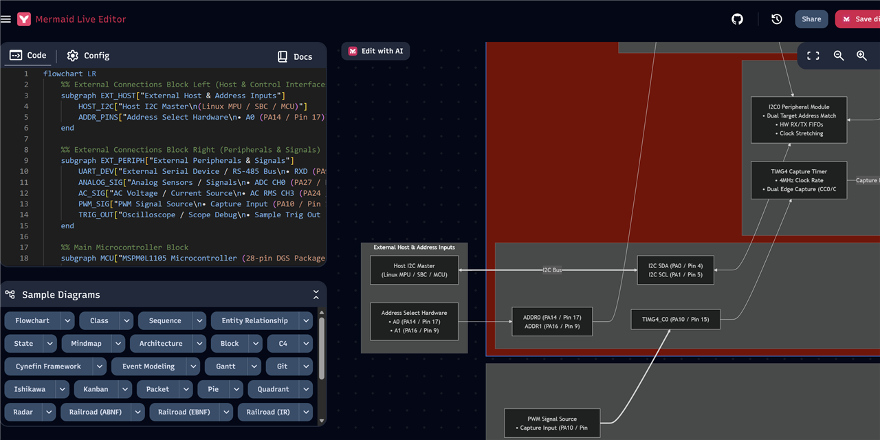

    Anyone tried Mermaid? It's an online diagram-drawing tool that accepts text-based input. I mention it because AI can be prompted to generate Mermaid output. Might not be correct always, but it can be useful to get an idea about a body of code that one might be new to.
    Example screenshot, where the red box is my microcontroller.

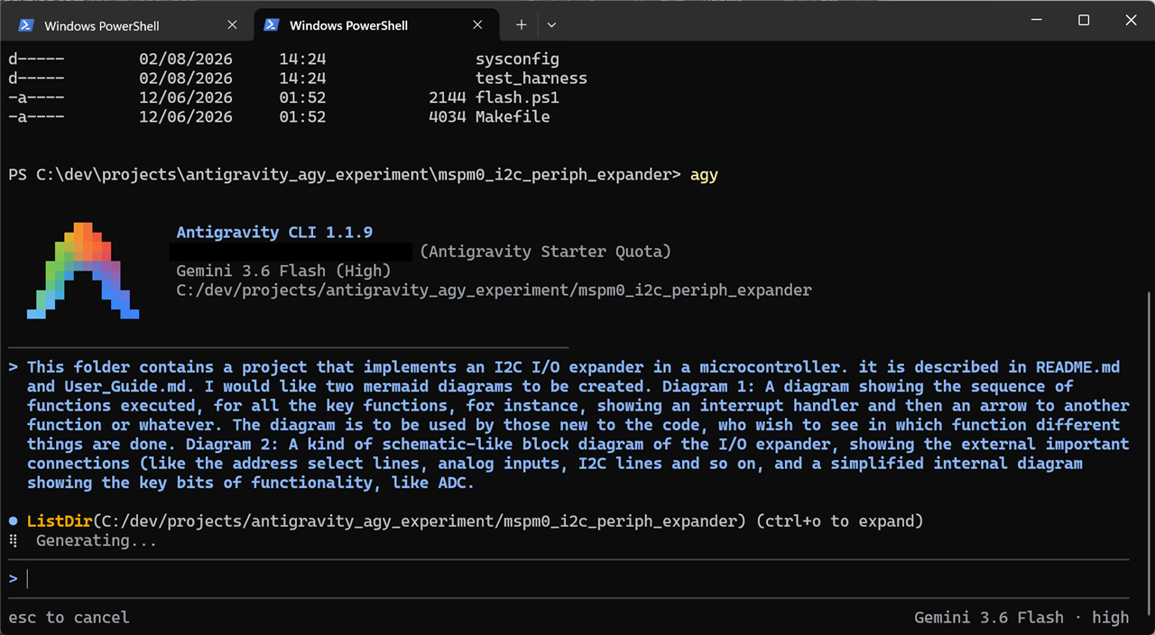

    To do this was quite simple:
    1. Install AntiGravity CLI (or use whatever AI you wish; AntiGravity is the consumer way of accessing the functionality in Google Gemini).
    2. I used Windows PowerShell. I went to the folder where my body of code was, and ran AntiGravity (by typing agy) and then just explained in text what I wanted:
    If you were say using ChatGPT you could have uploaded the files, or perhaps simply provided the URL if the code was on GitHub, and so on.
    3. The output was a file called ARCHITECTURE_DIAGRAMS.md
    4. I copy-pasted the diagram from the .md file into the Mermaid website.
    I can use the diagram to refresh myself about how the code is architected.
    Personally I like drawing my own diagrams because I prefer reducing them for as much simplicity as I can manage, but it is still useful for a quick reference.
