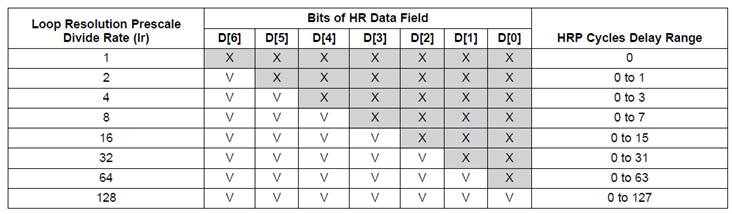

The MCMP instruction's compare value exists of 2 pieces of data, named hr_data and data.
You have to fit the number 468 in that.
Depending on the lr setting, you have a number of bits of that 468 that 'll fit in the hr_data. The rest has to go into data.
Our lr is 1, so we don't have access to the hr_data. So we have to skip the whole 6 bits of hr_data.
468 =  111010100b
left shifted by 6 bits: 111010100000000b
The right 6 bits ( 6 LSBs) (I know this is silly, but in the TI app note they have an example where the lr = 8, so that explains it better because they will have hr_data bits) have to go to hr_data:
hr_data = 000000b = 0x00
The remaining bits (all MSBs exept the 6 LSBs) go to data: 111010100b = 0x1D4

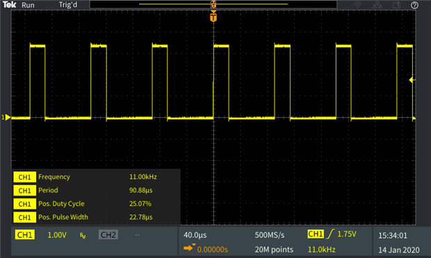

The result is the PWM signal shown in the post header: 11 kHz, 25% duty cycle.

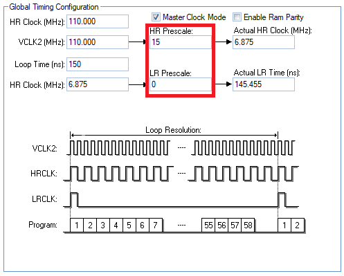

To make things somewhat more confusing, a hr of 16 and a lr of 1 are configured like this in HALCoGen image  :

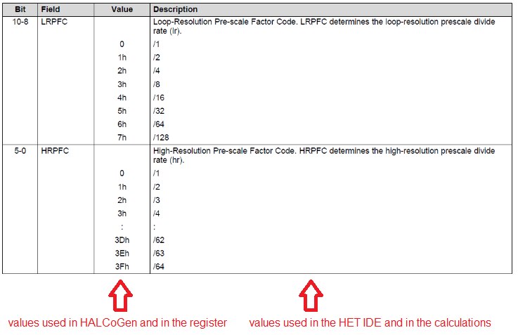

This is because they represent the values as explained in the technical reference manual for the PFR register:
    /** - Setup prescaler values
    *     - Loop resolution prescaler
    *     - High resolution prescaler
    hetREG1->PFR = (uint32)((uint32) 0U << 8U)
                | ((uint32) 15U);
You have to use the translation table from that manual (see above, I've copied the relevant parts called LRPFC and HRPFC) to get the values that are to be used in the calculations.

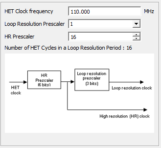

In the HET IDE, the same prescalers are configured so:
These are the translated values. I hope that by writing this down here, I never ever have to look this up again in the manuals and code.

    The PWM signal in the HET simulator:
