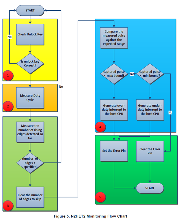

This project uses the timers of a TI Hercules microcontroller to generate complex digital signals and to measure digital signals.
In this post: measure the the duty cycle of the previous post and take actions when it's about a certain range. The actions are:
  • put a pin high as long as the duty cycle stays outside the accepted range (error output)
  • throw an interrupt to the host microcontroller
This project is based on TI's application note spna178: Monitoring PWM Using N2HET.
That note explains the functionality and has a link to a Code Composer Studio project .
I'm using these as the source for the blog series.

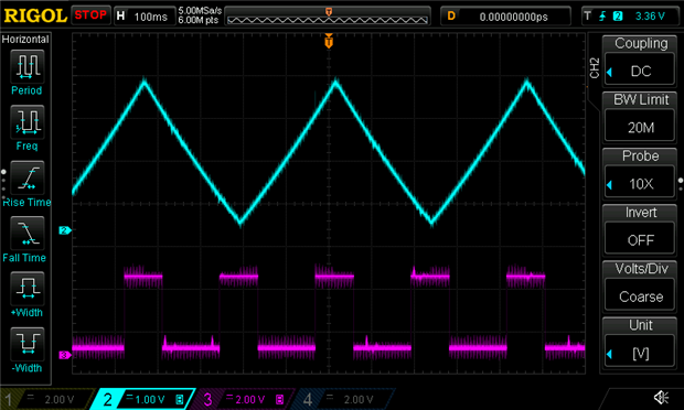

Measure a Pulse Signal's Duty Cycle
The HET module is not only a signal generator. It can read inputs too (actually it does not have to do any I/O. I'm re-learning the module because I want to use it in a project as a software only timer).
It can then do calculations based on if/when the input is a high/low or just changed. You can make time measurements based on events. You can count.
In this case, we constantly measure edges, and calculate the duty cycle relation. If you measure 3 transitions. You can calculate duty cycle based on that.
Then, we compare the duty cycle with a desired range. We (for exercise reasons) consider duty cycles between 20 and 80% valid, the others outliers.
When the HET module detects that a duty cycle is an outlier, it pulls an error pin high.
At the same time (this is our choice here. Looking for an excuse to test HET interrupts image ), it also raises an interrupt with the host controller (the ARM core).
The ARM core gets info whether the interrupt is fired for a "< 20%" situation or a "> 80%" situation. It maintains a counter for both and increments it whenever one of the two outlier cases happen.
I hope you understand this is an arbitrary example to show how measuring and taking actions based on that works.
TI has chosen to kick off two reactions when a certain situation happens: put a pin high and throw a host controller error. These are (practical and good to learn!) example reactions.
Putting the error output high and low takes no main controller clock ticks. The HET module does that all by itself
Try it: run the program in debug mode and halt the main core. The HET modules keep on generating the triangle wave and keep on measuring and driving the error output.
If you decide to raise an interrupt with the host ARM core, controller cycles will be consumed.
That's natural. We're handing over the handling of a situation to the ARM controller. It needs the clock ticks to manage that. That's no different from receiving a UART buffer full interrupt or anything else...

void hetNotification(hetBASE_t *het, uint32 offset) {
  if (offset == (pHET_L08_1+1) ) {
    greater_than_max_duty++;
  } else if (offset == (pHET_L10_1+1) ) {
    less_than_min_duty++;
  } else {  /* Should never come here */
    while (1);
If you pause the program during a debug session, you can check how many duty cycles were outside the preset range. In our case, that will be 20% of all pulses lower and 20% of all pulses higher.
While you're holding the main arm core, the HET blocks will keep on spinning. They are really two autonomous controllers.The interrupts thrown during that time are ignored by the halted ARM core.
One of the indicators that the HETs are autonomous is the main loop of this project:
  while(1) {
Core doesn't do anything. It'll get sidetracked at each interrupt, then happily spin further just burning energy.
What Did this Example Try to Convey?
  • That the HET modules can, all by themselves, perform fairly complex exercises, in a deterministic and constant pace.
  • They can be use as timers, can drive and read hardware pins.
  • Can communicate with the ARM core and vice versa. By exchanging data, via interrupts and (not covered in this example) by the HTU module (a DMA-like engine that works without the standard DMA module to avoid contention with any other block in the package.
  • That I still have a lot of learning to do. This example helped t grow knowledge but also made me realise I'm still at the start of the curve.
I've attached a fresh version of the project to the first blog. In that version I've refined the adaption to the TMS570LC43 LaunchPad and corrected some bugs.
