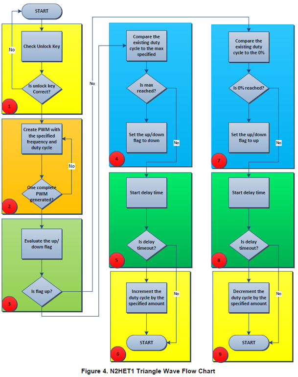

Program running on HET #1: triangle wave generator
The first program uses the timer to generate a pulse train sequence that, by changing the duty cycle continuously, mimic a triangle wave form.
It will linearly increase the duty cycle and, when reaching 100% decrease the duty cycle until 0%. Rinse and repeat.
source: TI's application note spna178: Monitoring PWM Using N2HET, showing the triangle waveform logic

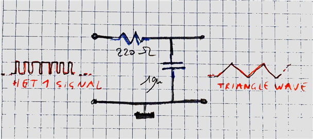

If you run that waveform through a low-pass filter, you get a triangular wave.

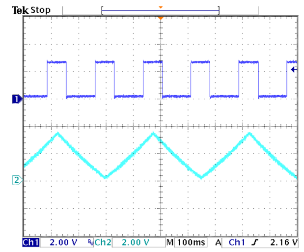

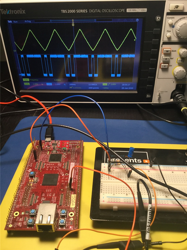

In the scope capture below, light blue signal 2 is the output of HET program 1, after passing through the low-pass filter.
image: a simple RC low pass filter
One of the attributes of this pulse train is that it has a wide range of duty cycles. Ideal for the second HET program below, a design that validates if a duty cycle is within certain bounds.
Some highlights:
  • the analog signal is just for your enertainment. The second HET program samples the duty train of the original pulse train generated by HET #1.
  • HET #1 generates this sequence without any input from the microcontroller. The only time the CPU is involved is at the startup, when it loads the HET code into memory and gives the GO! signal.
  • It shows how to exchange firmware data with the HET logic (for an example where HET and CPU exchange data extensively, check my Stepper Motor posts).

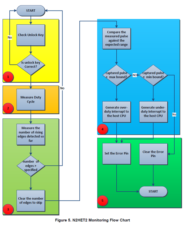

Program running on HET #2: duty cycle monitor
The first program samples the pulse train generated by HET #1. It measures the duty cycle continuously.
When the duty cycle is outside a given % range, it puts an output pin high, until the cycle is within range again.
Additionally (and the reason why I wanted to review this example), it raises a interrupt in the CPU.
That Interrupt updates two counters. An underrun counter in case the duty cycle was below the set range. An overrun counter in the case the duty cycle was larger than the uppder range we define.
Some highlights:
  • everything except the (optional) handling of the CPU interrupt run independent of the CPU clock
  • there aren't many examples around that show how to generate then react on a HET interrupt

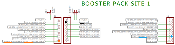

Triangle comes out of pin N2HET1_9.
That same signal is sampled (internally! the HET pin we use to sample is routed to the same pin, see later, and see the orange dot below) by N2HET2_16.
That means that in reality, you don't need to wire up any pins to see this example work. You'll see the interrupt wiring and the counters increasing without any witing.
But for your own interest, it's worth putting that output filter on the N2HET1_9 pin and probe both the filter output and the error output N2HET2_0.

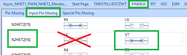

TMS570LC43 needs a PINMUX setting
By default, the TMS570LC43 routes N2HET2_16 to solder ball L4. It would not detect anything happening on the HET 1 output.
Set the pinmux for that signal to V7. The same BGA ball that has the NHET1_9 signal on it.

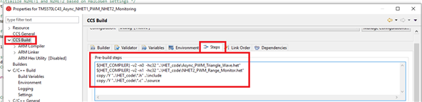

TI's project has the HET code pre-assembled. But it's more fun to let the build process do that. It allows you to change the HET code and see what happens.
First, create a HET_code subfolder in your project, and place both *.het files you find in TI's example project there.
Right-click on the HET_code folder and exclude it from build.

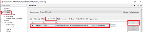

Create a build variable to the HET assembler (installed when you install HET IDE).
Then put the commands to assemble the *het files in the prebuild steps, and the code to copy the resulting .h and .c files to our source and include folders.
${HET_COMPILER} -v2 -n0  -hc32 "..\HET_code\Async_PWM_Triangle_Wave.het"
${HET_COMPILER} -v2 -n1  -hc32 "..\HET_code\NHET2_PWM_Range_Monitor.het"
copy /Y "..\HET_code\*.h" ..\include
copy /Y "..\HET_code\*.c" ..\source

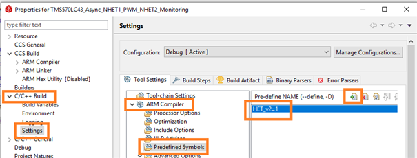

There's an inconsistency in the code generated by HALCoGen.
It has some conditional code that's dependent on the header file generated by the HET assembler. But it generates an include file sequence that only includes thet header file after trying to check the settings.
HALCoGen definition in std_nhet.h:
#ifndef HET_v2
#   define HET_v2 0
#endif
HET assembler definition, defined in a header file that HALCoGen includes after the above file (hence it doesn't know the definition when it tries to resolve the conditional code parts)::
#define HET_v2 1
TI knows (there are several posts on the E2E forum) but since both applications don't have a next release date, I'm not expecting a solution soon.
Here's a workaround: predefine the variable in the project settings. Set it for both debug and release.
Build the project, to check if the prebuild steps work. It will generate the asembled .h and .c files the first time. Don't run the project yet.

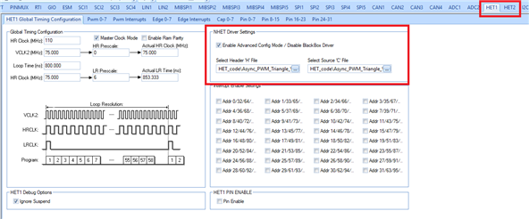

Then, in  HALCoGen, select the header and c files generated by this step to the HET1 and HET2 configuration page.
This step is just to make all tools work as you expect, without surprises. It does the same as the pre-build steps above, without first assembling the het source.

That's it. Build, run, enjoy. Put oscilloscope probes on HET1_9 and HET2_0.
