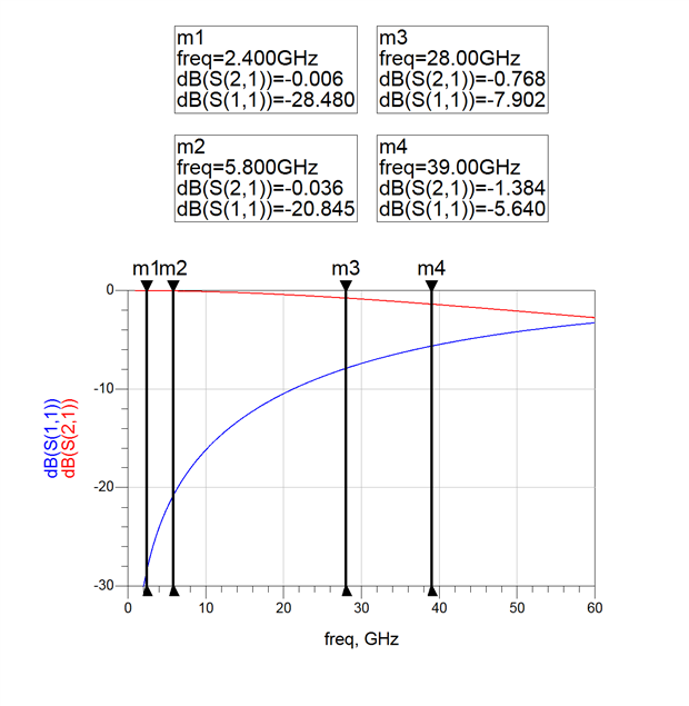

Although tapering the end of the route may seem a bit excessive, it can be shown that even a miniscule amount of parasitic capacitance can add a decent amount of loss and discontinuities to the transmission path. For example, a parasitic 0.1pF of shunt capacitance is negligible at frequencies such as 2.4GHz and 5.8GHz. On the other hand, when working at 5G frequencies such as 28GHz and 39GHz, the insertion loss can exceed one dB. Furthermore, the return loss becomes much worse. This can create undesired signal reflections and discontinuities in the signal path. This can further be seen in the plot shown below.
Figure 5. S-Parameters plot showing insertion loss and return loss due to 0.1pF of parasitic capacitance (Image credit: ME)
