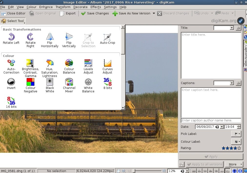

We need a sufficient screen resolution to manage the photo archive, directly operating on the native 24 Mp RAW DNG files; every file is between 20Mb and 30Mb. The CM3, as well as the traditional Raspberry PI3 is able to manage the HDMI out in Full HD format 1920x1080 px. The video below shows the results obtained with different screen sizes and resolutions tested with the same applications and a set of typical DNG file samples.
The application used for testing cover most of the needs of image archiving and post production: Digikam for image archiving - comparable to Lightroom and Aperture - including SQL relational database and many advanced features and Gimp. The most recent version of this image processing application can replace without problems the well known Photoshop. Both the applications can work natively with RAW DNG files.
The first tests has been done on a 21" HDMI screen connected to the CM3, set in Full HD resolution (settings can be changed with just a reboot editing the /boot/config.txt configuration file). Most of the tested graphic programs crashed apparently due the reduced available memory as well as the two mentioned above. The worry was that just because the Raspberry Pi has the limit of 1Gb of RAM the idea of an image post processing desktop included in the camera had to be abandoned; I have also tried to increase the shared memory over the 128 Mb via the raspi-config command without any new improvements in the performances.
We should also consider that the desktop environment was set to minimal trying to optimise as much as possible the resources:
  • Installation of the raspbian jessie lite on the eMMC internal flash memory of the CM3
  • Installation of the minimal X11 server by hand based on the Mate (used by Ubuntu Mate) that seems to be one of the most lightweight
  • No extra drivers than the bare essentials are running on the system
Anyway this scenario presented really bad performances to be considered unusable.
The strange aspect is that also with only 1Gb or available memory Linux will work well in a lot of complex cases so I tended to exclude the memory limit as the most blocking factor. Then I tried on two other different kind of screen: a 800x400 HDMI touch screen from Seed and the original 7" Raspberry Pi touch LCD screen . In both cases with the same conditions, just setting the new resolutions programs worked perfectly, at least there was different issues: small screens and low resolution made impossible to use proficiently the applications but these worked fast and without particular problems.
The HDMI screen sends its own resolution to the board that adapt the graphical resolution (with or without the overscan); so I forced different resolutions on the HDMI 21" LCD screen I tested first getting different interesting results. Depending on the resolution I set the performances of the graphic applications changed significantly and the best working resolution is 1024x768. Programs (almost) never hangs and also the most complex filters works fine directly on the native large RAW DNG files.

DigiKam has been setup to point to the default Pictures folder creating one album every subfolder. Then a series of test images has been loaded. The update of about 100 files, including the time to create the thumbnails was less than a minute.
The image gallery below show the screenshots of some test image when applying filters.
{gallery}
DNG loaded in the editor
Denoise filter loading
Zooming and image navigation is fluid
Full size preview after filter applying
Outdoor image color correction
Applying filters
Image ready to save and export
Loading outdoor image for Black & White conversion
B&W is one of the most complex filters
Black and White film type selection
Zoomed preview to check film grain
