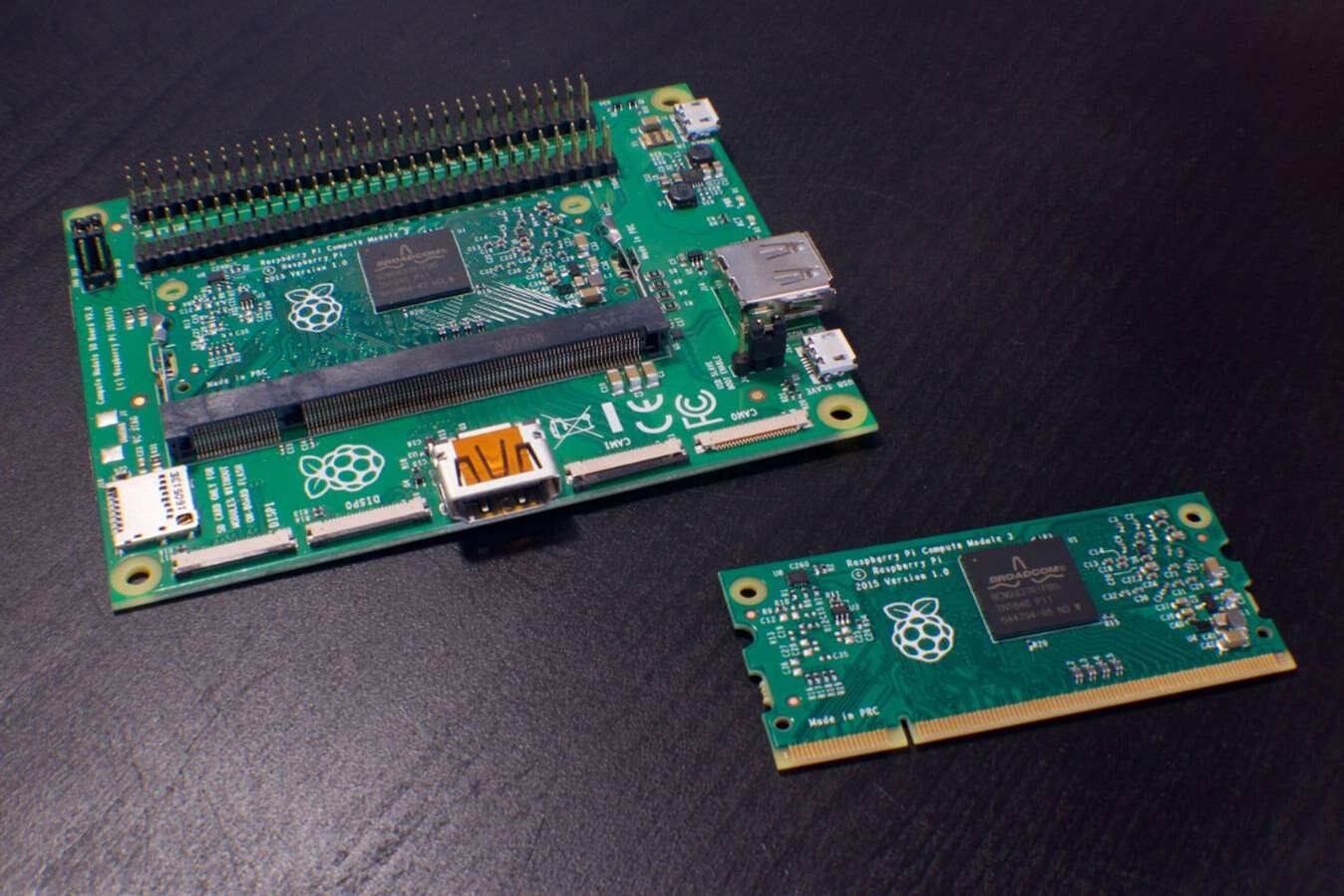

The core of the PONF camera digital back is the Raspberry PI Compute Module 3. This choice gives the device uncommon features: it is a specialised Linux embedded machine but a traditional digital camera as we are used to intend it.
The small and powerful Linux board is only one component of the PONF camera digital back connected to specialised modules through an internal network, based on four main protocols: UART, I2C, SPI and USB. A so organised modular system gives to the device a considerable compute power when it is used as a digital camera. When the back is put in place inside the dock station converts in a reliable desktop device with HDMI output, wireless connectivity and an extra USB hub to connect peripherals like printer, keyboard, mouse, graphic tablet and more.
Compute Module 3 tasks
Acting as a digital camera the Compute Module 3 covers the main role of managing the subprocesses in charge to the connected micro controllers, manage the storage, control the SONY 25 Mp APS-C full frame sensor and the external communication through USB, WiFi and Bluetooth.
Following a similar approach to the Raspberry Pi Desktop the Operating system is installed on the internal 4Gb eMMC of the Compute Module 3 while the rest of the filesystem is installed on a 1Tb SSH. This makes a reliable platform  with a lot of storage space for applications and images. In our case for better robustness of the system the Linux filesystem after boot resides on the SSD storage; a 500 Gb version will also be available.
