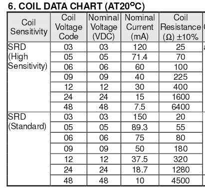

Why is the transistor Q3 required in this circuit of a optocoupler and a relay. Can't I directly attach the power pin of the relay to the opto coupler pin 3 and ground the other pin of the relay. I tried it and it works. Just want to know why is it not implemented and why is the transistor required.

    Ah yes, I see what you mean. Possibly the switching current for the relay coil is higher than the optocoupler can safely provide, so the transistor is there to do the job instead.

    You don't provide enough information for a definitive answer - for which I would need the part numbers or specs of the relay and the opto-coupler.
    However, typically a normal opto-coupler will have a coupling of between 10% and 50% - which means that for 5mA in the LED you can expect a collector current of between 0.5 and 2.5mA maximum. The relay will probably need a current of about 50mA to turn on.
    Some opto-couplers are specified for much higher gains so may be able to reliably operate the relay but it is likely that using a standard low cost opto-coupler and  a transistor will be cheaper and offer a greater operating margin.
    Another thing to look out for in the coupler spec is the maximum output current - which may not be enough to operate the relay.

    You haven't given me the key opto-coupler parameter - what's the coupling coefficient (current transfer ratio) ?
    Take a look at the data sheet for Farnell 2323137 a Farichild  FOD817FOD817 on page 4 they give the key parameters in the table"DC Transfer Characteristics there will be a similar table in the data sheet for the device you have

    Yup, its a current buffer.  The output Q and the extra Q form a Darlington pair.  When one Q is NPN and the other is PNP, it is a Sizlacki pair.  Output Qs of run-of-the-mill optocouplers have low ampacity (how I hate that word!) and are susceptible to spikes.

    The simple answer is the opto coupler is only rated for 50mA while the relay is either 72 or 90mA.
    Under some circumstance you may be able to drive it (although it may not pull in correctly), but these have issues being drivn by a Raspberry Pi.
    The 3v3, series resitor and LED n the input side combine to be just on the edge of triggering even with the transistor.
    The answer is to add a second 1K across the resistor (R5 in the schematic).

    There should be some notion of design margin.  Even if, say, the optocoupler Q is rated at 30mA and the relay coil is rated at 30 mA, the buffer Q should still be employed.  There is such a thing as specsmanship.  There is such a thing as design (process) variation.  There is such a thing as not being a stunod.  For every 10 degree K more heat (temperature rise, heat is not measured in Kelvins) you put into a device you halve its lifetime.
