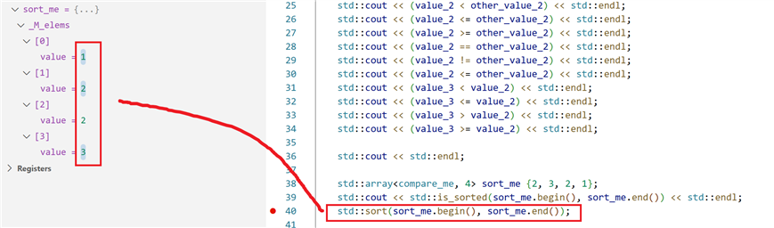

Bonus: use STL sorting algorithm on a container of our objects
This is functionality that you get when you provide the <=> operator.
Example: execute a few STL algorithms on an an array of (initially) unsorted objects
#include <array>
#include <algorithm>
    std::array<compare_me, 4> sort_me {2, 3, 2, 1};
    for(const auto& cm : sort_me) { std::cout << cm << " "; }
    std::cout << std::endl;
    std::cout << "sorted? "<< std::is_sorted(sort_me.begin(), sort_me.end()) << std::endl;
    std::sort(sort_me.begin(), sort_me.end());
    std::cout << "sorted? " << std::is_sorted(sort_me.begin(), sort_me.end()) << std::endl;

    Jan Cumps over 1 year ago in reply to Jan Cumps
    example 2: sorting.
    (note: I did not have to write the algorithm):
    example 1: use STL to check if an array is sorted:
    one of the advantages of this mechanism, is that the STL built-in sorting algoritms work.
    If you have a container (e.g.: array, vector, list,...) of your objects, you can tell STL to sort them.
