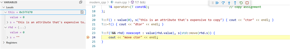

T::T(T&& rhd) noexcept : value(rhd.value), s(std::move(rhd.s)) { // move contructor
    cout << "move ctor" << endl;

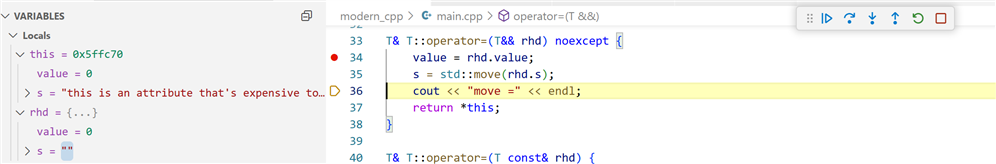

T& T::operator=(T&& rhd) noexcept { // move assignment operator
    value = rhd.value;
    s = std::move(rhd.s);
    cout << "move =" << endl;
    return *this;
move constructor
If you construct a new object from an existing one, and that original one goes out of scope, C++ will select the move constructor. Here's an example of code that can (and will) invoke the move constructor:
T move_to(T t) {
    return t;
int main() {
    T u = move_to(T());
This function receives an object as pass-by-value. So it's an object on its own. Then we return it to a calling application, where it will be received into a variable.
What C++ does, if you have a move constructor: it will use that constructor to create the object in place in the receiving variable. And use your move code to move the string member from the parameter object to the new object. You "transfer the ownership of that string member from parameter t to the newly constructed object. The parameter object is then destructed.
If you move an object into the place of another, C++ can (and will, if you provided it) call the move assignment operator. And use it's capability to transfer ownership of expensive data members to the receiving object. An example is, to assign an object to a particular location in an stl array:
    std::array<T, 4> array_of_t;
    array_of_t[0] = T();
The temporary object T() is moved into the container. The object at array_of_t[0] gets the ownership of T().s. Without copying the data over. That T() object is then destructed.

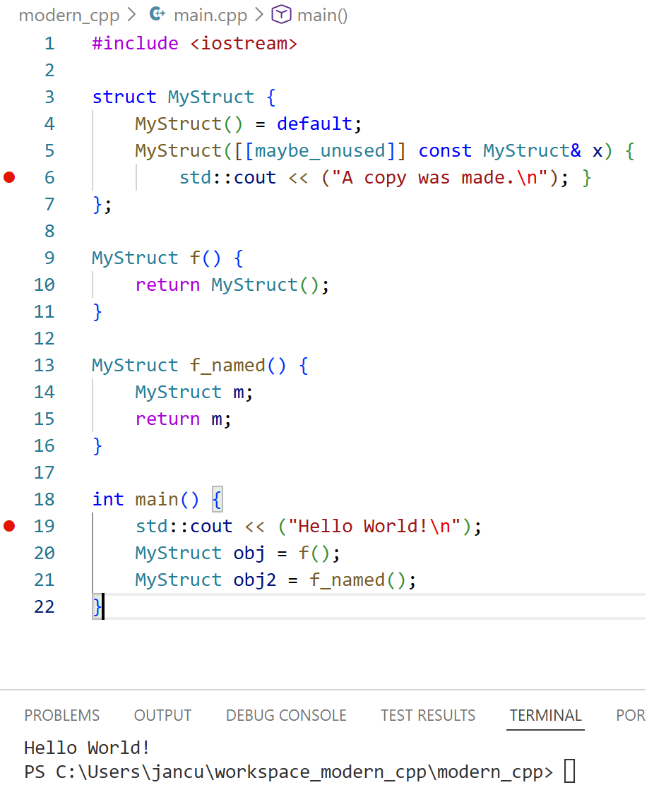

    I used wikipedia's test case to check if C++ actually manages to allocate an object, created in a function, directly in its final memory location: yes
    #include <iostream>
    struct MyStruct {
        MyStruct() = default;
        MyStruct([[maybe_unused]] const MyStruct& x) {
            std::cout << ("A copy was made.\n"); }
    MyStruct f() {
        return MyStruct();
    MyStruct f_named() {
        MyStruct m;
        return m;
    int main() {
        std::cout << ("Hello World!\n");
        MyStruct obj = f();
        MyStruct obj2 = f_named();
    obj and obj2 are 2 MyStruct objects. Even though they are created inside functions ( f() and f_named() ), there is no copying when these 2 functions exit.
    They actually construct the object in the memory that's allocated in main directly.
    C++ knows that the function return values are temporary and not used after the function exits.
    So instead of creating a temporary object, and using a copy into obj or obj2 at return, it directly does the work in the destination object.
    result: using a function to factor an object comes without any runtime cost.
