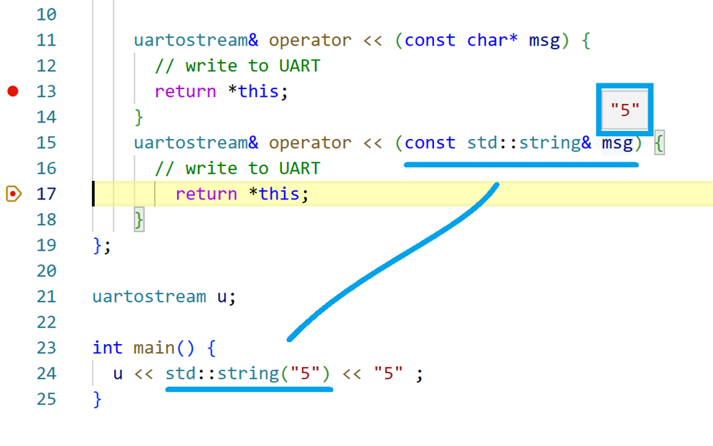

Notice that the class doesn't do anything with them. In this first post I want to check if the code compiles. And I use a debugger to see if the strings arrive in their handlers. If I put a breakpoint in the handler methods, and the msg parameter contains the string we've streamed to it, the mechanism works.
using the class
In the example code, I'll stream a std::string and a classic c-style char string.
#include <string>
class uartostream{ // see previous section for class definition
uartostream u;
int main() {
  u << std::string("5") << "5" ;
test
I put a breakpoint in both operator << members. The code should first halt in the one that takes a std::string reference. Then the one that takes the c string.
The screen capture above shows the state while streaming the first part. If you want to see what happens when the "5" is streamed: try it in your favourite C++ IDE.

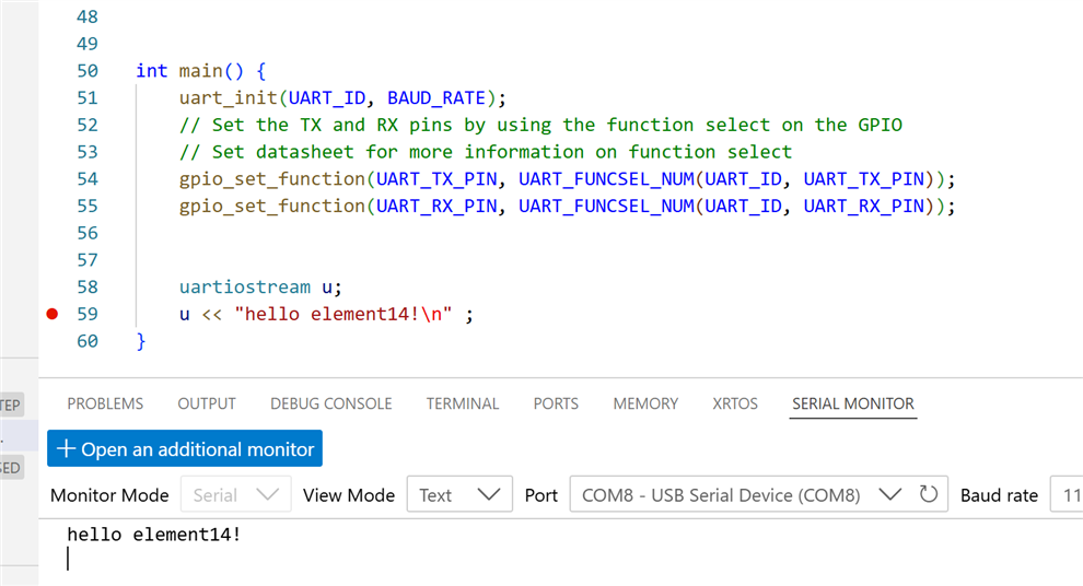

    a real world example. Implementation for a Raspberry Pico. Using its UART api:
    Code:
    class uartostream {
    public:
        uartostream() {}
        uartostream& operator << (const char* msg) {
            uart_puts(UART_ID, msg);
            return *this;
        uartostream& operator << (const std::string& msg) {
            uart_puts(UART_ID, msg.c_str());
            return *this;

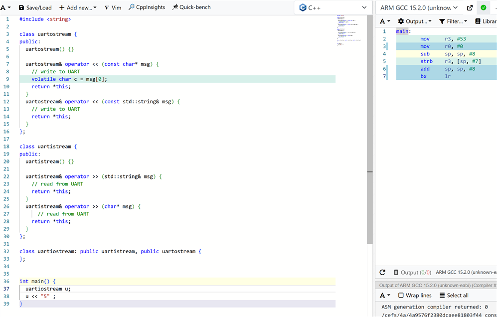

    If I don't create u as a global; it's 100% the same for C++ objects vs C code. The OO approach has 0 overhead:
    main:
            mov     r3, #53
            mov     r0, #0
            sub     sp, sp, #8
            strb    r3, [sp, #7]
            add     sp, sp, #8
            bx      lr

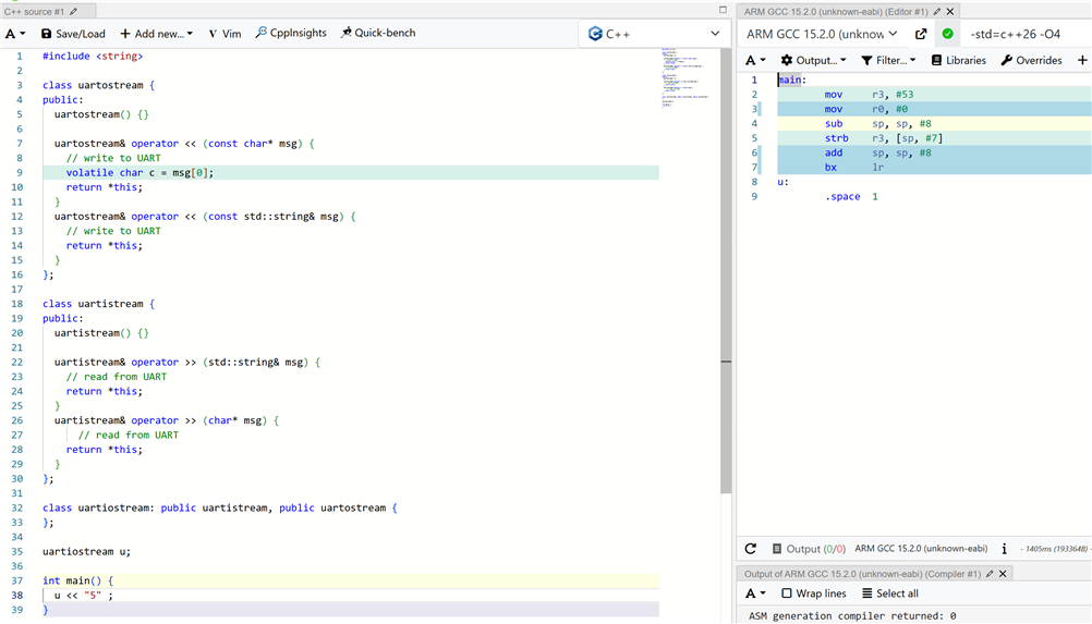

    Is this expensive? The facts
    When I use a subclass uartiostream and its << operator:
    This compiles to
    main:
            mov     r3, #53
            mov     r0, #0
            sub     sp, sp, #8
            strb    r3, [sp, #7]
            add     sp, sp, #8
            bx      lr
    u:
            .space  1

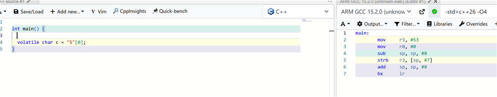

    when I use plain C to do the same:
    main:
            mov     r3, #53
            mov     r0, #0
            sub     sp, sp, #8
            strb    r3, [sp, #7]
            add     sp, sp, #8
            bx      lr
    The only difference is a single address location (32 bits) to hold the object u
    0 cpu cycles
    That's virtually cost-free
