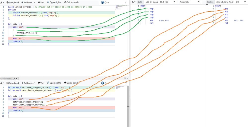

    this code was used for the comparison:
    C
    inline void activate_stepper_driver() { asm("nop"); }
    inline void deactivate_stepper_driver() { asm("nop"); }
    int main() {
        asm("nop");
        activate_stepper_driver();
    // code that uses the stepper here
        deactivate_stepper_driver();
        asm("nop");
        return 0;
    C++
    class wakeup_drv8711 { // driver out of sleep as long as object in scope
    public:
        inline wakeup_drv8711() { asm("nop"); }
        inline ~wakeup_drv8711() { asm("nop"); }
    int main() {
        asm("nop");
            wakeup_drv8711 w;
        asm("nop");
        return 0;
    Jan Cumps over 1 year ago
    Pre-empting the question: but how much overhead?
    none.
    The "nop" calls are there to "do something" so that the optimiser doesn't completely remove this example code.
    Jan Cumps over 1 year ago in reply to embeddedguy
    there is no dynamic memory allocation involved in this.
    (edit:
    you can see that because there is no new() involved in this code.
    also; because there is no data member, this object actually takes 0 bytes, nothing. It only exists in the C++ "conceptual realm".  you don't find anything back in the runtime.
    The only effect is that the code in the constructor is inserted where the scope is entered, and the code in the destructor is inserted where we leave the scope.
    Exactly same effect as the C code at the start the blog
