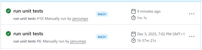

    Jan Cumps 3 months ago
    GitHub now has free Ubuntu 26.04 runners (in preview). You get it by setting runs-on to ubuntu-26.04
    jobs:
      test:
        runs-on: ubuntu-26.04
        steps:
          - name: Clean workspace
            run: |
              echo "Cleaning up previous run"
              rm -rf "${{ github.workspace }}"
              mkdir -p "${{ github.workspace }}"
          - name: checkout
            uses: actions/checkout@v4
            with:
              path: test_gps_teseo
              submodules: false
          - name: Install dependencies
            run: |
              sudo apt-get install ninja-build
              sudo apt-get install cmake
              sudo add-apt-repository universe
              sudo apt update
              gcc --version
    In particular useful if you use GCC 15. On the previous Linux runners, you have to build that from source, and that's a long process.
    Ubuntu 26.04 has it as the default GCC compiler version
    gcc (Ubuntu 15.2.0-16ubuntu1) 15.2.0
    This brings the test execution time of one of my projects back from almost 2 hours to 1 minute and 1 second.
    That 1 minute is spent on
    • getting an OS up and updating it,
    • get make related tools (CMake, Ninja)
    • check out the project source from GitHub
    • build the project
    • run test suite
    • clean up
