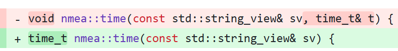

    Jan Cumps 7 months ago
    I'm making a few changes to the nmea lib API and code: let the library return objects, instead of passing them via output parameters
    Since C++17, the compiler can directly use the object that receives the return value. So no constructors or copies are called in this mechanism.
    Old version:
    void nmea::time(const std::string_view& sv, time_t& t) {
    	std::string s(sv);
    	t = time_t{
    		std::chrono::hours(std::stoi(s.substr(0,  2))) +
    		std::chrono::minutes(std::stoi(s.substr(2,  2))) +
    	    std::chrono::seconds(std::stoi(s.substr(4,  2))) +
    		std::chrono::milliseconds(std::stoi(s.substr(7)))
    New version (uses exactly same amount of resources):
    time_t nmea::time(const std::string_view& sv) {
    	std::string s(sv);
    	return time_t{
    All API functions that use an output parameter have been adapted. I'm running tests to see if any regression happened...
