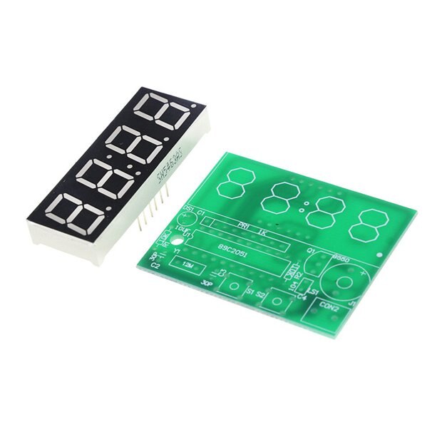

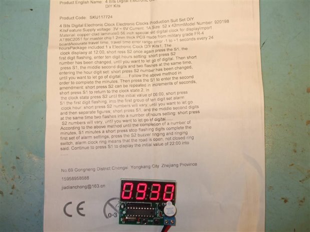

I've been looking for a project that would be suitable for young Boy Scouts, and have decided that one of these DIY clock kits would be something that even the youngest could put together.
Most of the kits appear to come with an AT89C2051 (they all seem to come with the same pcb as well), so I've also searched out code that the older scouts could program additional AT89C2051s with. I'll reach out to the local university to see if they've got a programmer that we can use, but the boys won't have access to one after we're done making these. I think having a couple extra chips to swap around with different programs would be cool to them.
The clock comes with a standard clock program, but I'm still looking for a simple countdown timer and a simple stopwatch. By "simple" I mean something that I can show the scouts, and explain commented snippets of the code.
The code that I've found has been on forums where the members haven't been active for years, so I can't ask them followup questions.
If anyone could help me out with simplified code for two projects, I would greatly appreciate it. I can reassign pins in the code if the boards end up being pinned slightly different than what is pictured (you never know with these things).

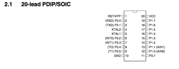

    That's assembler code, which is likely what you'll need to do for the AT89C2051, unless you can find a C compiler and linker (I have no idea if that is practical for that chip, and it will require some…
    0 shabaz over 8 years ago
    Hi,
    The attached code is for an Arduino, which contains a different microcontroller compared to AT89C2051. The code isn't compatible.
    You could rewrite the code for AT89C2051, but you'd almost have to start from scratch, since even the LED display is different, yours appears to have 12 pins, and the one that the Arduino code is for has 16 pins, so yours is multiplexed differently, and that would need to be deciphered too. So, a non-trivial exercise to do this, but possible.
    The AT89C2051 is a really ancient chip, so although you'll likely find information on the Internet on how to program it and perhaps some example programs to get you started, personally I don't have any example source code for this microcontroller - I think I maybe briefly used it >10 years ago. Personally I wouldn't advise it, because you'll need to source a programmer and compiler, and most of this is really ancient as mentioned. Better to just have a construction project with it using the pre-programmed chip supplied with the kit perhaps, and have a different project if you want to demonstrate different code.

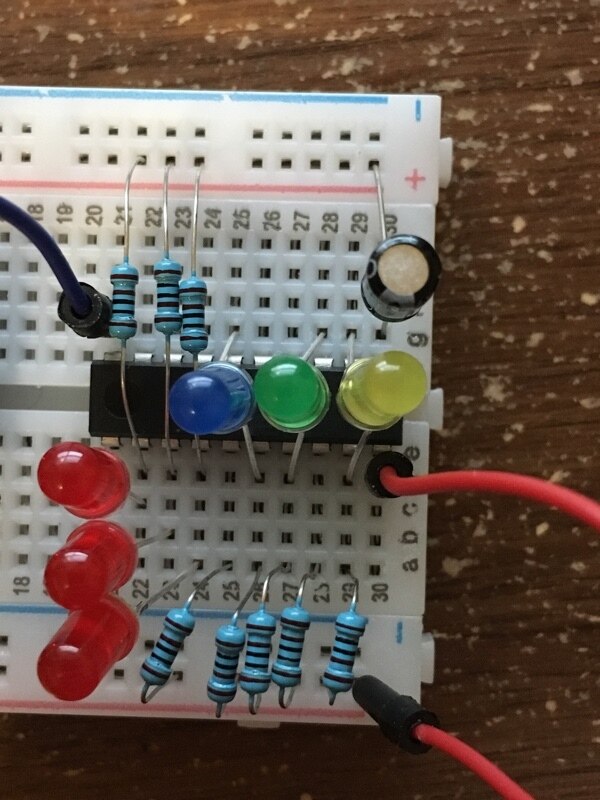

    This guy shows how to set up the original clock. https://www.youtube.com/watch?v=q421PYti3Ic
    Ive been messing with code, but i think I need a different programmer for the ATtiny4313... so I've been searching YouTube for How-to vids and checking out their equipment.

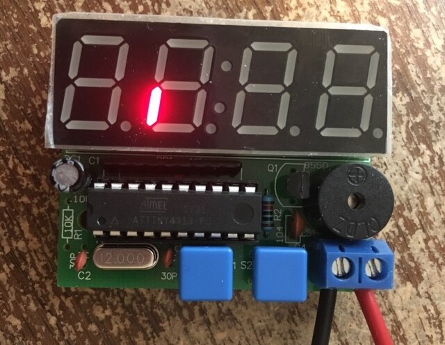

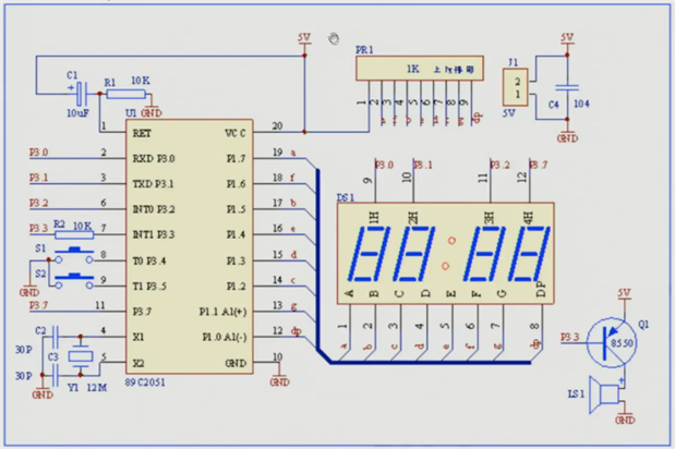

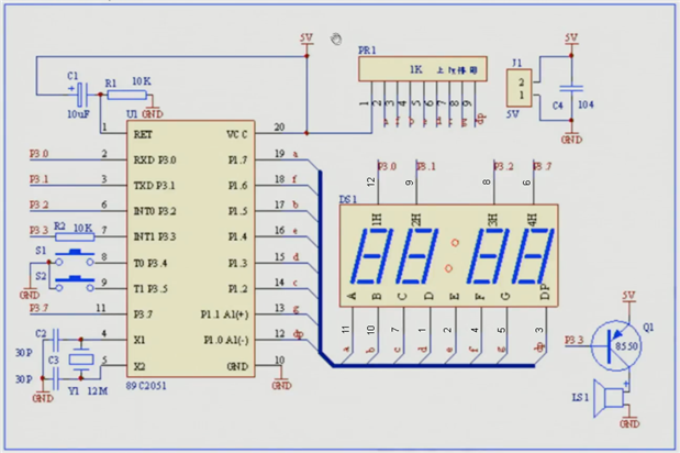

    The rest of my kit came in, and everything is assembled, so my first attempt is to get the display working with a simple program.
    It turns out that the schematic associated with the clock is incorrect. I've updated the schematic below with the display pin numbers to match the PCB layout.
    I haven't been able to verify that the segment order is correct, nor if the digit order is correct, because I'm still trying to wrap my head around how it works using sip resistors.
    Would you turn OFF the segments by setting the segment pins LOW (and digit pins HIGH) to pull the 5v away from the display?
    Then set the digit pin LOW to select the digit, and the segment pin HIGH to divert the 5v back to the segment?
    EDIT: I've confirmed a few of the display pinouts (above), so I'd imagine that the rest are correct also.
    I've gotten to the point where I can blink the display ONCE (without control over duration) then the display becomes unresponsive.
    - Setting the digit pins to HIGH, and the segment pins to LOW disables the display.
    - Setting pin0 (digit pin 12) to LOW, and pin10 (segment pin 5 'g') to HIGH gives me a short "-"blink.
    - Setting pins 0, 1, 4 & 8 (digit pins 12, 9, 8 & 6) to LOW, and pin10 (segment pin 5 'g') to HIGH gives me a short "----"blink.
    I still don't fully understand how to drive the display when using pull-up resistors on the segment pins.
    Am I right in that HIGH=SOURCE and LOW=SINK?
    Or do you need to use LOW to SINK (divert power), then "FLOAT" the segment pins to allow the LED to pull power through the 1K resistor array?
  • fbtjbt

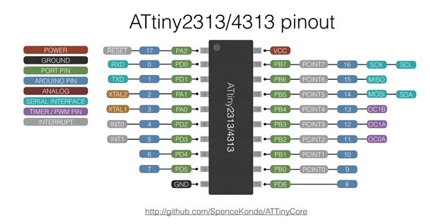

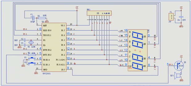

    At my nephew's request (one of the Boy Scouts that I will eventually be instructing), I have also started experimenting with ArduinoIDE.
    I've simplified the schematic for the boys who are new-to-electronics, and added ArduinoPinNumbers in Blue:
    (note that the cathode for dp is digit2, the dp anode lights all segments [making a dim "8"] when digit 1, 3, or 4 cathodes are connected.)
    My limited experience leads me to believe that this should blink "-" on digit one, but it doesn't repeat:
    int segmentPins[8] = {16, 15, 14, 13, 12, 11, 10, 9};    // SEGMENTS A11, F10, B7, E1, D2, C4, G5, DP3
    int digitPins[4] = {0, 1, 4, 8};                                        // DIGITS (1)12, (2)9, (3)8, (4)6
    void setup() {
      for(int i=0; i < 8; i++) {
        pinMode(segmentPins[i], OUTPUT);   // SET SEGMENT PINS TO GND:  OUTPUT+LOW = SINK 5V / INPUT=ON
        digitalWrite(segmentPins[i], LOW);
      for(int i=0; i < 4; i++) {
        pinMode(digitPins[i], OUTPUT);     // SET DIGIT PINS TO GND: OUTPUT+LOW = ON
        digitalWrite(digitPins[i], LOW);
        pinMode(digitPins[i], INPUT);        // TURN OFF DIGIT PINS: INPUT=OFF

  • michaelkellett
    0 michaelkellett over 8 years ago in reply to fbtjbt
    In your dash blinking loop I think you need a delay between un-grounding and grounding so that the segment has some time on.
    MK
    • Reject Answer
  • fbtjbt
    0 fbtjbt over 8 years ago in reply to michaelkellett
    Thanks for catching that. I missed that line while I was typing it here on the forum (now edited to include it).
    I started out using the standard 1000ms delay for the on/off, but the led only flashed once for about 250ms then..... nothing.
    It doesn't blink at all when I put a delay(2000); at the beginning of the void loop.

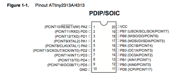

  • fbtjbt
    0 fbtjbt over 8 years ago in reply to jc2048
    I was using this as a reference for the 4313 ArduinoIDE pinout:
    Am I using the pinMode() incorrectly for this chip?
  • jc2048
    0 jc2048 over 8 years ago in reply to fbtjbt
    I don't know.
    I was just going by the processor pin-out you showed further up. Pin 13 can function as an input to the A/D, so maybe it's treated differently in the same way as would be the case with the analog pins on an Arduino.
    I was just suggesting it as something you could try.
