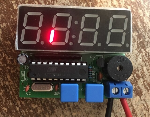

Code for small diy clock kits.
fbtjbt
fbtjbt over 8 years ago

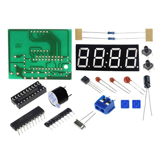

I've been looking for a project that would be suitable for young Boy Scouts, and have decided that one of these DIY clock kits would be something that even the youngest could put together.

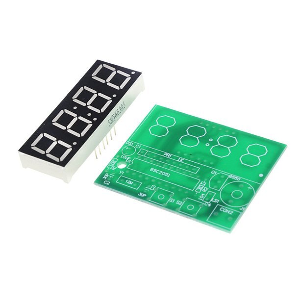

Most of the kits appear to come with an AT89C2051 (they all seem to come with the same pcb as well), so I've also searched out code that the older scouts could program additional AT89C2051s with. I'll reach out to the local university to see if they've got a programmer that we can use, but the boys won't have access to one after we're done making these. I think having a couple extra chips to swap around with different programs would be cool to them.
The clock comes with a standard clock program, but I'm still looking for a simple countdown timer and a simple stopwatch. By "simple" I mean something that I can show the scouts, and explain commented snippets of the code.
The code that I've found has been on forums where the members haven't been active for years, so I can't ask them followup questions.
If anyone could help me out with simplified code for two projects, I would greatly appreciate it. I can reassign pins in the code if the boards end up being pinned slightly different than what is pictured (you never know with these things).

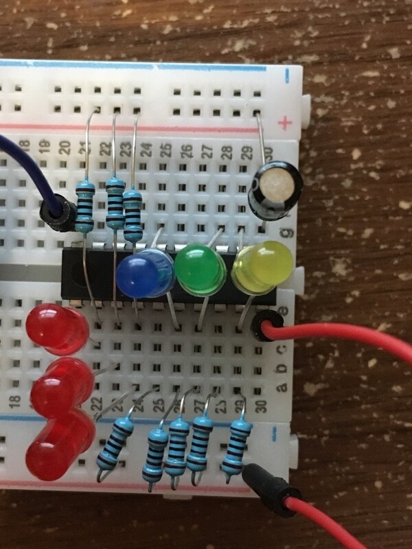

    Thanks for responding! I saw your post as I was getting ready to post more info about the project.
    I, too, would have gone a different route with the pcb design if I were doing this from scratch. I'm stuck with PR1 because that's the way the board comes.
    I setup a breadboard to mimic the way the DIY Clock display is set up. I didn't have a sip resistor array, so I put 1k resistors from the +rail to the LED/controller.
    Yellow is attached to Digit1 cathode,
    Green is attached to Digit2 cathode,
    Blue is attached to Digit3 cathode,
    Reds are attached to Digit4 cathode,
    and they are attached to 6 different anodes.
    This bit of code works to blink the "segments" (in a charliplexing-sort-of-way) on the breadboard:

    I ran into a problem when I put the 4313 back in the DIY Clock, though. It blips the first segment, then appears to crash.
    A check over the schematics showed that the DIY Clock has a 10k resistor @ R1, which my breadboard didn't have.
    As soon as I removed R1, the code worked! It happily drives the Common Cathode display using Sip resistors.
    I seriously can't believe how much time it has taken to reverse engineer this little clock, then to write code that only tests the segments of the display.

    That's awesome, thanks! I like the idea of including the pinout for the IC in a commented section of the code.
    I've got the "countdown timer" just about done using ArduinoIDE (as requested by me nephew). Everything works, but I haven't figured
    the best way to switch between hh:mm / mm:ss / ss:ms.
    - button1 + button2 == switches between hh:mm / mm:ss / ss:ms ("Hr:  " / " :S " / " S:  ")
    Otherwise, I think the Programming Merit Badge is a go!
    I'm sure these boys will enjoy soldering, programming, and playing with this little DIY clock!
