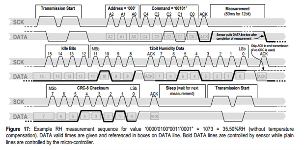

Hi,
I have written the c code for I2C for interfacing the SHT11(temp sensor) and PIC24F16KA102. but i m not getting the acknowledge from the SHT11 when i m writing through pic.  i m pasting my code here. plz let me know where i m doing wrong if possible. thanks

    Hi jalpa,
    I suppose that you are using MPLAB IDE plus XC16 complier, rigth?
    In your code you:
    #include "i2c.h",
    but you never use it, you are using own function declared and coded in your main.c, right?
    If you have chosen the PIC when create the project, you do not need to:
    #include <p24Fxxxx.h>
    After includes and defines, configuration bits are missing, (the configuration bits MPLAB utility is very usefull!!).
    I recommend you using the functions in i2c.h, like OpenI2C1(), CloseI2C1(), MasterWriteI2C1(), StartI2C1(), StopI2C1(), etc... the function to use will depend on the configuration of the bus when OpenI2C.
    I hope that helps,
    Miguel

    Normally, you use I2C by soft when you do not have a dedicated hardware for I2C, mainly when you use software to emulate such a dedicated hardware, the CPU has to deal with all the delay, timings, pooling, checking flags, whereas if you use dedicated hardware (with interruptions), CPU has just to configure the hardware just once, and let the hardware deals with most of this work, making lighter the workload of the CPU.
    I see you try to use a the dedicated registers and flags, so better use the functions given by XC.
    If you configure the hardware, and when write, you don't receive the slave ACK, check you have configured correctly the address mode and the SCL speed of the I2C, maybe the sensor is not receiving correctly what it is expecting.
    Hope that helps,
    Miguel
  • gihu
    0 gihu over 12 years ago in reply to e14 Contributor
    Probably you have a very usefull help file, path could look like this C:\Program Files (x86)\Microchip\xc16\v1.21\docs\periph_libs\Microchip PIC24F Peripheral Library.chm.
    Where every function is explained.
    Maybe it is obvios, but do not forget the pull-up resistor in both lines SCL and SDA.

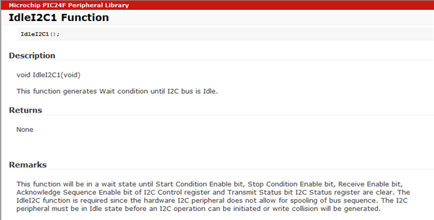

    0 e14 Contributor over 12 years ago in reply to gihu
    hi,
    i have tried the following code from example of library. but still i m not getting ACK as 0 in I2C1STAT register when i debug the code and watching status of I2C1STAT register. i m pasting here code as well as configuration file data. i m using PIC24F16KA102 related board that is Microstick 3.3V. Pic works at 32MHZ so its Fcy is 16MHz and according to 100KHZ of SCL i have kept baud rate generator count as 157(refereed from data sheet of pic). plz let me know where i m doing wrong. thanks
    code:.........................

       IdleI2C1();
       StartI2C1();

    About the IdleI2C1():
    After a StartI2C1(); you can wait until start condition enable bit is clear.
    After a StopI2C1(); you can wait until stop condition enable bit is clear.
    After a MasterWriteI2C1(); you can wait until transmit status bit is clear.
    And so on.
    Or for all these functions I think you can use IdleI2C1() instead of checking their own flag.
    So, it seems you can get the data_high but not the data_low....Have you tried changing AckI2C1 by NotAckI2C1 and viceversa?

    Sorry jalpa I did not either realize that the sensor is not I2C... image
    Check this:
    - Put a break point in line:
          error=DATA; //check ack (DATA will be pulled down by SHT11)
    Check Data value in the physical Line SDA,
         if 'low', sensor is responding, so put a break point in line
                   if(DATA) error+=1; // or timeout (~2 sec.) is reached
                   Check what was the reason of exit the previous loop, i gets 65536 or D==0, if i gets 65536 the sensor does not end the measurement (remember using Pull-up resistor)
         if 'high', sensor is not responding:
                   - Can you debug your code step by step? (in MPLAB I recommend you using F7 step into, because it is the shortest step). If yes run again the code from the begining, and when start the transmission of the command:
    for (i=0x80;i>0;i/=2) //shift bit for masking
    { if (i & value) DATA=1; //masking value with i , write to SENSI-BUS
    else DATA=0;
    SCK=1; //clk for SENSI-BUS
    delay_us(5); //pulswith approx. 5 us
    SCK=0;
    check every time that the status of both lines SCK and SDA are what you are expecting. When the command is sent keep on stepping and check the status of SDA when you get to line
    error=DATA; //check ack (DATA will be pulled down by SHT11),
    If now SDA is low means that sensor works, so maybe it is timing problem,
    Check this, and let us know what you get.
    Sorry for not giving a more concise answer but without the board and the sensor is difficult to try the code...image
