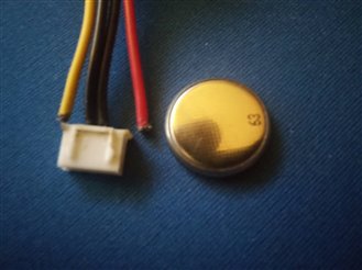

Hello,
Can you guys help me to find out what the name is of this connector in the photo, there is a CR2032 battery next to it for size reference.
This connector is from a converter to molex.
As you can see the cables came lose/broke and now I have to replace the connector to get it working again.
Thanks in advance!

    Hi Tim, I don't know the name of the connector but I have repaired this type of problem in the past. I begin by pushing the pins out the back of the connector. There is a little metal finger on the side…

    I don't know the name of the connector but I have repaired this type of problem in the past. I begin by pushing the pins out the back of the connector. There is a little metal finger on the side of the connector that will release the pin. Then I solder the wires back to the pins being careful to keep the solder job small enough to slip back into the connector. The little metal finger on the pin needs to be repositioned so the pin will stay in the holder. Usually I will add some heat shrink to add strain relief.
    These directions have been modified after I looked more carefully at the pictures you provided.

    0 e14 Contributor over 11 years ago in reply to jw0752
    Hi John,
    I thought of doing that, but I think it's not reliable and I don't have steady hands to perform it. I will just try to find a replacement cable.

    Hi Tim, Here is a link to Newark Electronics connectors. I saw one, part # 54H7664 that looked similar. At least it gives you a place to start.

    Dose the other end of your cable look like this?
    Is the cable used in your computer?
    What are you connecting to it?

    your picture looks more like a floppy drive connects. Let's wait and see but the discussion connector seems a little different, more like from a battery plug. but we'll see. Not always the cheapest, but if soldering goes south. there is always ebay or an old part and just cut wires and join from the wires not in the connector. (not elegant but might work)

    Hi Tim,
    Indeed knowing where this connection is used would help try to locate it on google.
    Sometimes the schematic of the device may also list the correct connector part number in the parts list.

    To me it looks a lot like JST-PH : http://www.ebay.co.uk/itm/JST-2-0-PH-4-Pin-Connector-Plug-with-Wire-x-10-Sets-/111380527989
    Please do check the pitch, whether the pins are 2mm or 2.54mm apart. Easiest way to check this is to measure the distance between pin 1 and pin 4....

    You can try to search XH-4A. It is used wildly in China. I don't konw how to call it in USA.

    Yes this is it!!! Thank you so much! I also found the name of the product where the cable came from. It is from the Eminent EM1015 | USB to IDE / SATA.
