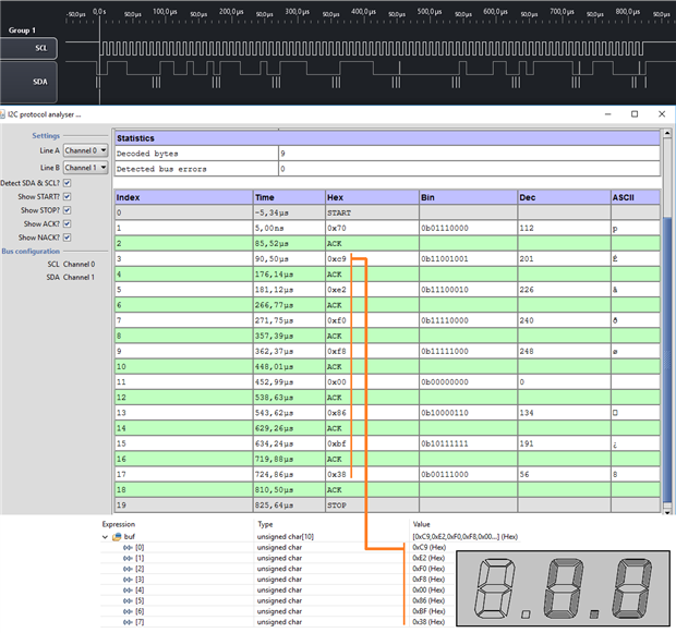

Let's have a look at the I2C traffic. I used the Hercules port that I made of Shabaz' example to capture it.
What data is flowing according to the code?
Our code tries to send 9 bytes.
  • 1:          the 7-bit I2C address + read/write bit
  • 2 - 6:    config and commands
  • 7 - 9:    data for the segments and dots

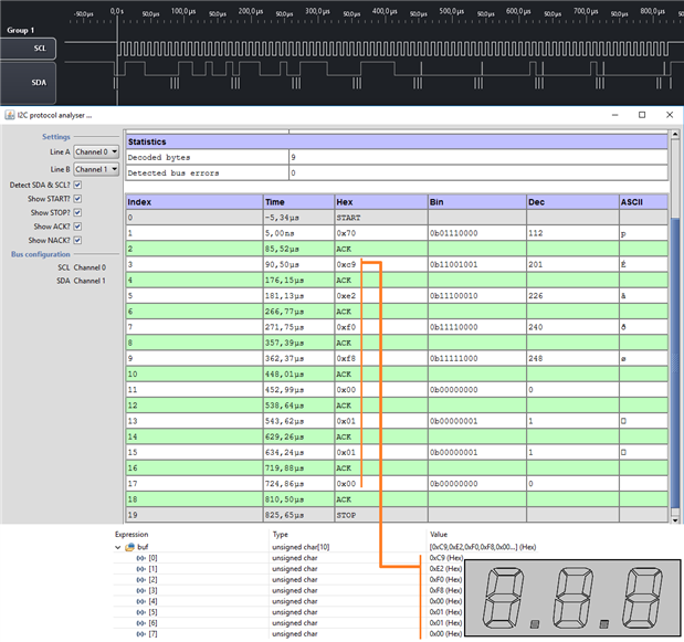

What's really flowing to the LCD Controller
These two captures are the result of sending ' . . ' and '  0.0' to the display:
Everything looks as expected. On the odd lines from 3 to 17 we find exactly what's defined in the code.
Line 3 in the screen captures, with value 0xc9, is exactly what's assigned to buf[0]in the code.
  mode=0xc9; // Set static mode, display enabled, continuation enabled
  buf[0]=mode;

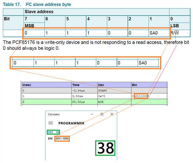

The only thing that may need some more clarification is the I2C address, on line 1.
We've set it to 0x38, but in the transfers there is 0x70.
That's part of the I2C protocol.
The address isn't 8 bit, but 7 bit.
That 7 bit value is appended with a read/write bit. 1 if we're reading, 0 if we're writing.
Because we're writing to the LCD, we append the address with a 0.
The value 0x38 left shifted and with the last bit set to 0 equals 0x70.
