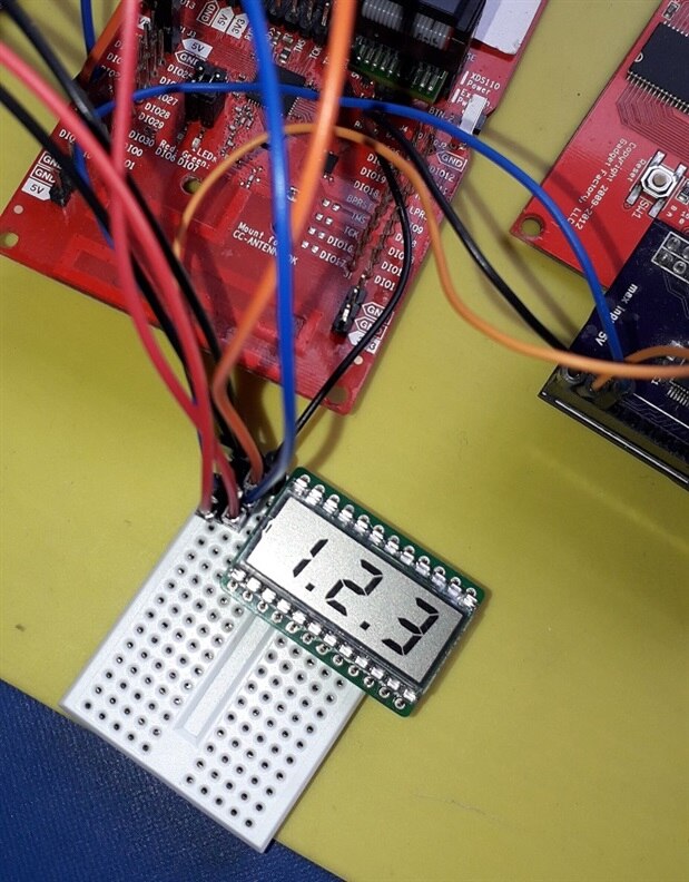

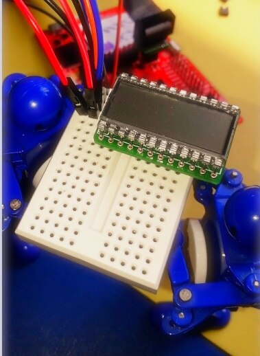

I've ported it to the TI-RTOS I2C driver.
The display code should work on MSP432, CC1X and CC2X families. I tested it on a CC1310 Sub-1 GHz LaunchPad.

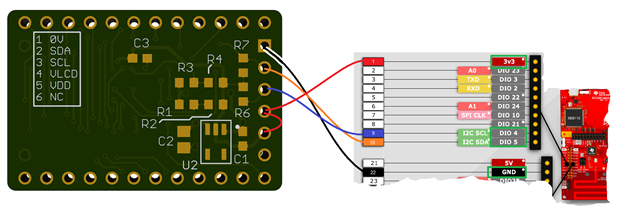

Hardware and Connections
You'll need 4 connections. 2 for the 3V3 DC power and 2 I2C lines.
Here's an example for the SimpleLink CC1310 LaunchPad:
Adapting to Your Design
The I2C pull-up is a little high in my case, because both the LaunchPad and LCD board have the pull-up resistors mounted.
In a real situation you would only populate one set of resistors.
Depending on what address you configured on the LCD board, you may have to change your code.
My board was configured for address 0x62.
#define DEVICE_ADDR 0x62 /* this is different than the GIT code. The PCB is configured for 0x62 instead of 0X60 */
