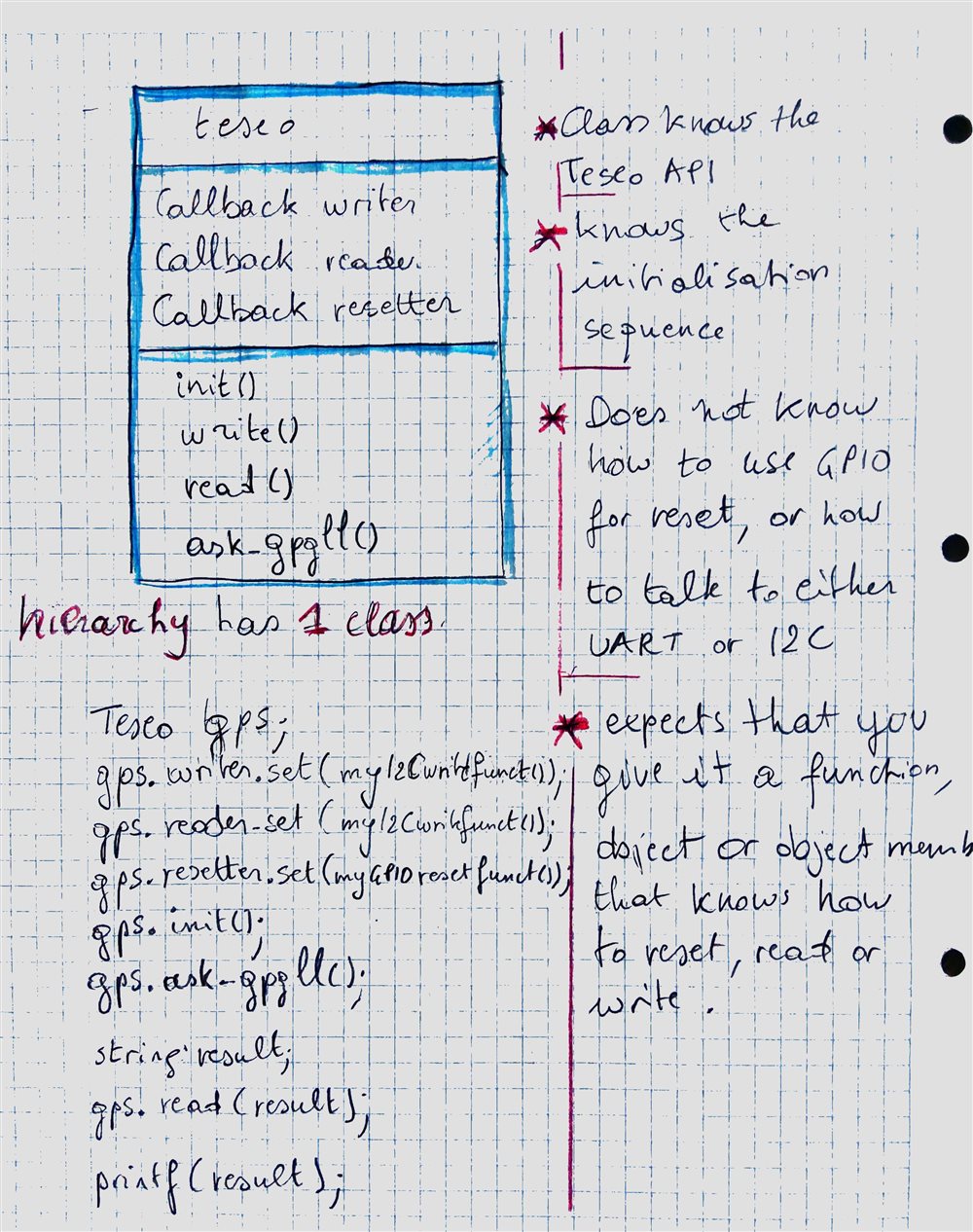

The library has 1 class, teseo. It understands (a little part of) the Teseo command set and replies. For the communication, it relies on I2C functions that I provide. I'm reusing the Callback mechanism that I posted here.
The picture shows how the design uses dependency injection. The Testeo class can be used as-is on each microcontroller family. You give it (inject) the platform logic to read, write and reset.
I talk about reset here, but that's a subject for the next post, where I add that functionality.

Because I delegate the device dependent (and protocol dependent) communication mechanism, the Teseo class itself can focus on the Teseo's protocol. Its only role is to keep the conversation going. It will grow in a next version, when I'll learn it to parse the $GPGLL answer, and maybe do some other things like returning time.
If you look back at this class, you'll see that there are 0 lines that rely on Pico's SDK or on I2C.

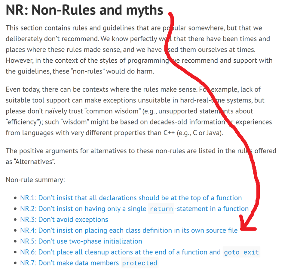

    Jan Cumps over 1 year ago in reply to shabaz
    (we had an unwritten coding standard/gentleman's agreement to only have one class per header+souce files
    see C++ Core Guidelines:
    genebren over 1 year ago in reply to Jan Cumps
    Rules were meant to be broken?
    shabaz over 1 year ago in reply to Jan Cumps
    Plus I suspect some things made better sense in the past, when people were just using editors or very basic IDEs. One side benefit of the one-class-per-file was that each file was named the single class name, so you'd just seek out in the file system the particular class you were interested in. I used to have a graphical tool to see which files were modified (I needed that for checking in the code too).
    Nowadays no-one would do that, since the IDE will locate your class definition and functions in a second.
    I can see why it's a "non-rule", since it almost encouraged people to cram things in to classes where it didn't make sense, rather than take the overhead to create (and version-control and document etc) new files!
