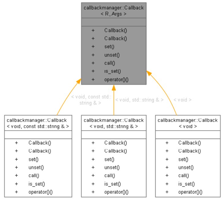

    As part of the exercise, I tamed the Doxygen output a bit. The documentation is auto-generated and published when a commit is pushed to the main branch on GitHub.
    Because the dependent libraries aren't submodules of the repository anymore in this version, I can't just run Doxygen after checkout. The code is not available yet.
    What I've done: in the doc generation script, run a build. That causes CMake to download the dependent lib sources. I then tell Doxygen where to find these sources. A few changes in the doxygen script itself, take care that the documentation removes the actual locations of these depedent libs:
    FULL_PATH_NAMES        = NO
    STRIP_FROM_PATH        = build/_deps
    Works like a charm.
