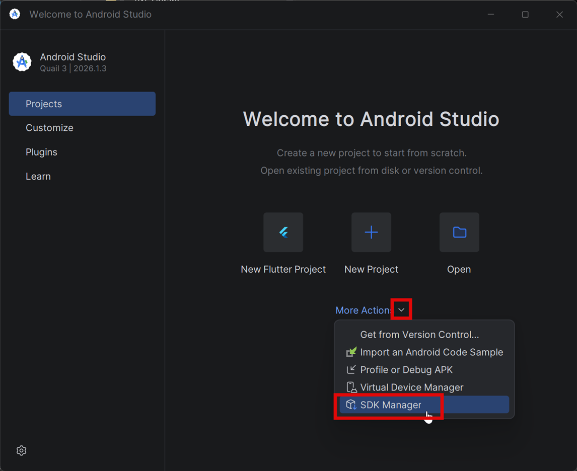

Run Android Studio, and from More Actions, select SDK Manager.

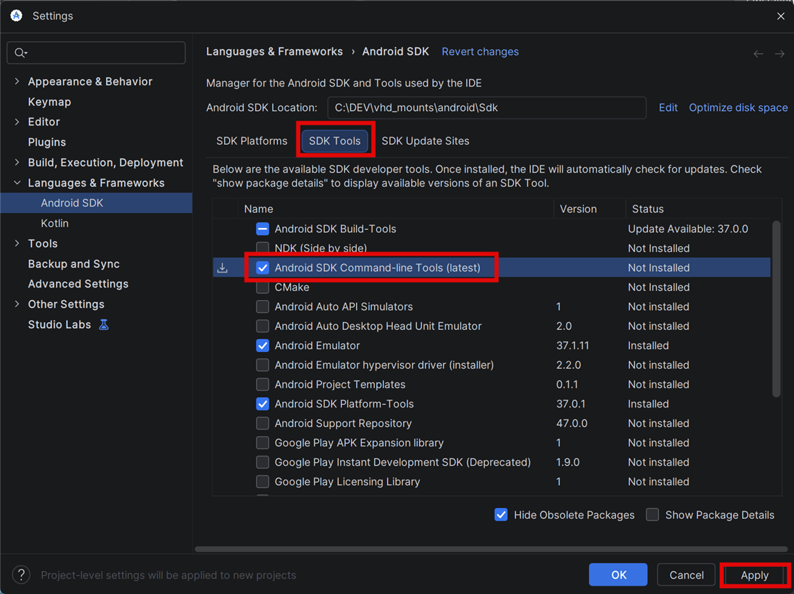

Go to SDK Tools, and enable command line tools as shown below. Click Apply, and wait a short while for it to install.

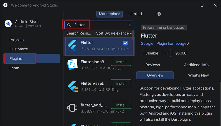

Next, go to Plugins, and install the Flutter plugin. Note that you still need to install Flutter itself; that will come next.

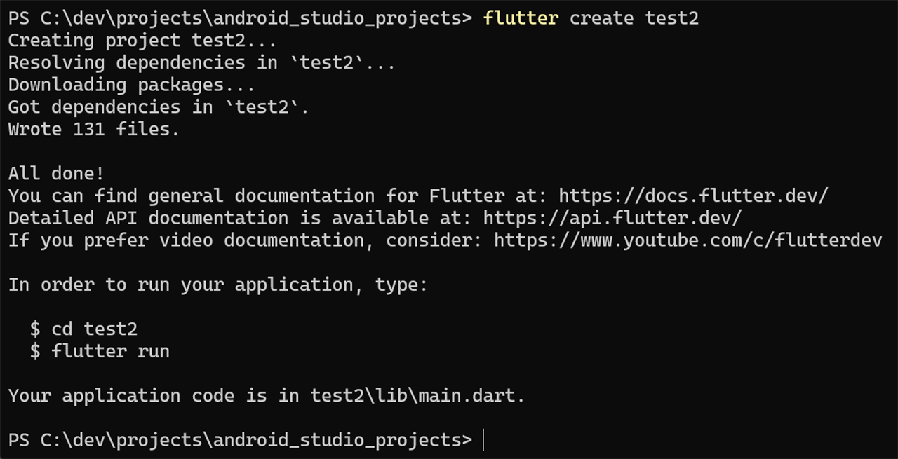

Creating a Project
Create a folder for android project. My path was:
C:\DEV\projects\android_studio_projects
Open up a PowerShell, go to that folder, and type (all lower-case!):
flutter create <your_project_name>

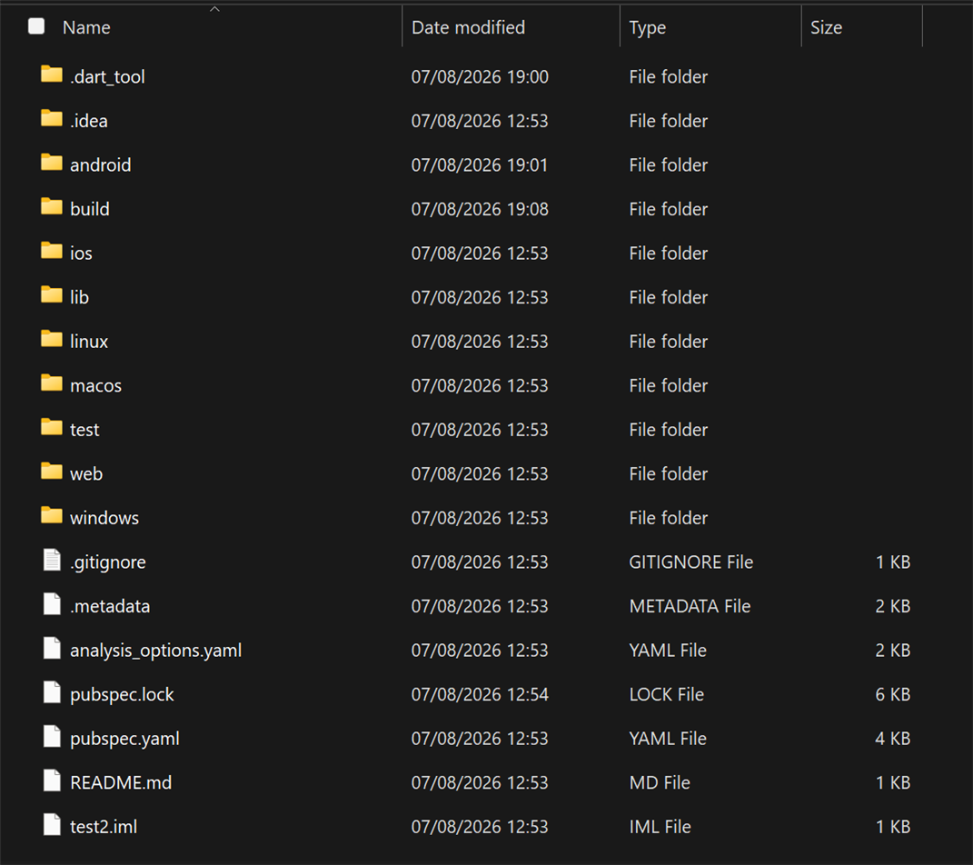

You’ll see that a load of files got created:
Using PowerShell, go into the project folder (test2 in my example), and then type the following to run some sanity checks:

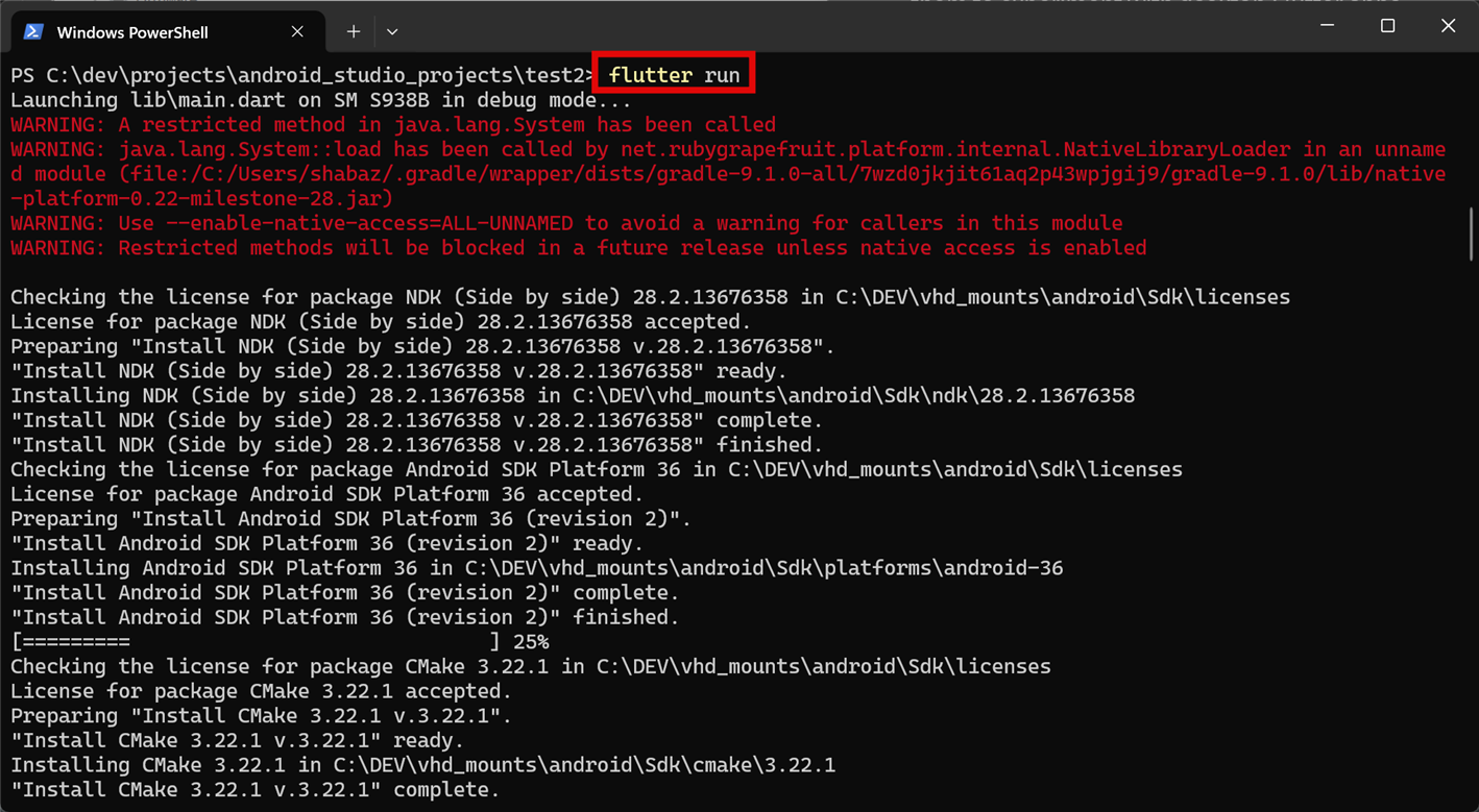

Running the App
You can type the following in a PowerShell window, in your project folder:
flutter run
Note that it will take some time to execute the first time! Long enough to make tea/coffee.

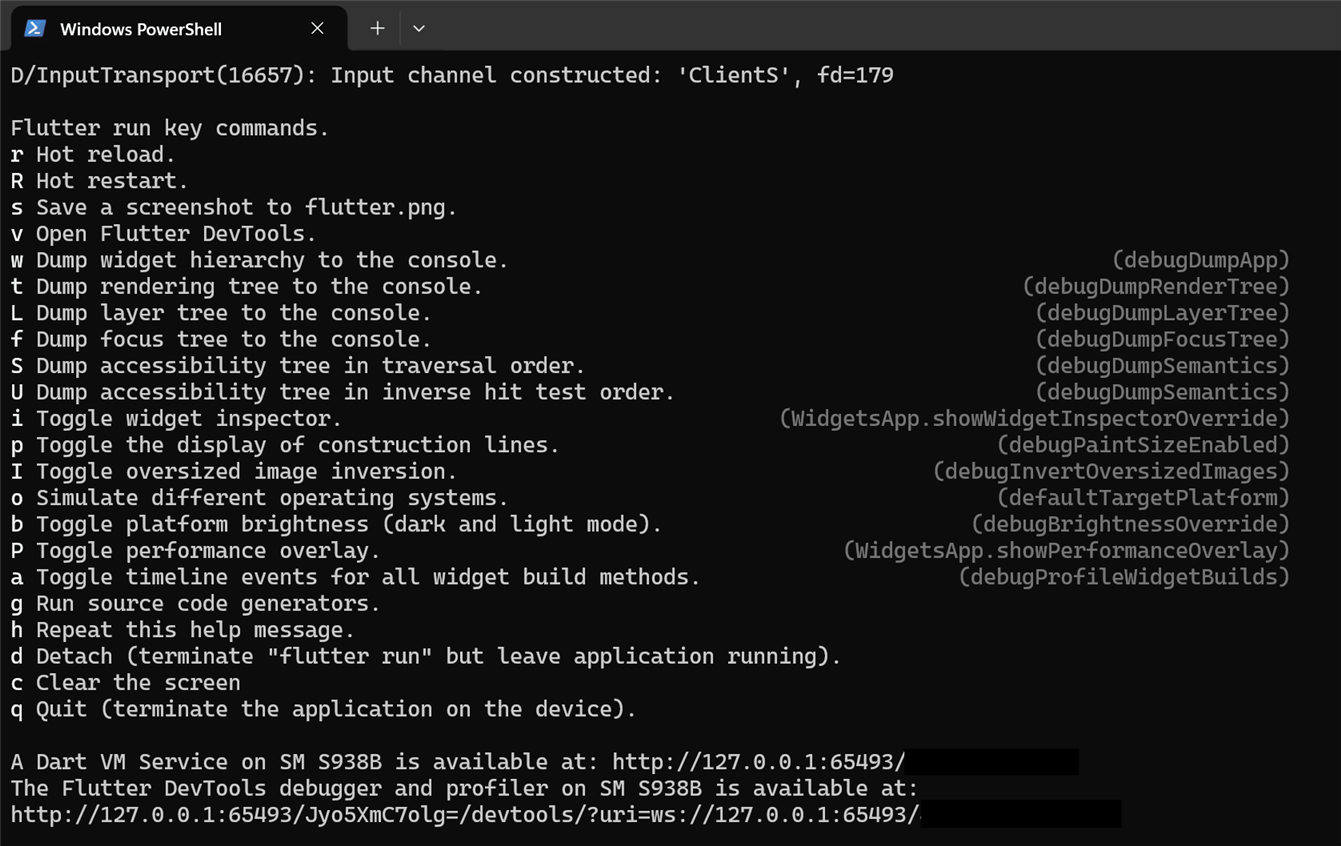

There’ll be a ton of scrolling text, but eventually, on the mobile phone, an example flutter app appears!
In PowerShell, press ‘h’ to see a list of commands:
Project Folder Explained

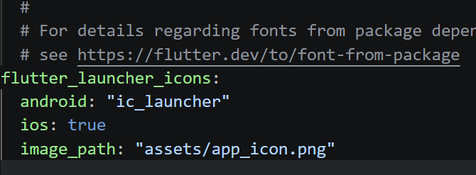

The project folder contains quite a lot, but in practise, the most important things to know are that the project source is in the lib folder, and then there are a load of platform-specific folders (such as android, ios, linux, macos and so on) that may occasionally need to be touched (to edit the project name, permissions, and so on).

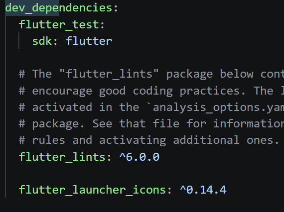

The pubspec.yaml file is important, this is where any packages are entered as dependencies (such as code libraries) that the project may require.
Note that if you add dependencies in pubspec.yaml, then you’ll need to type the following to install them:
flutter pub get

Creating an App Icon
Create an assets folder in the project folder.
In pubspec.yaml, under dev_dependencies, add this entry:
flutter_launcher_icons: ^0.14.4
At the end of the pubspec.yaml file, place the following:
android: "ic_launcher"
ios: true
image_path: "assets/app_icon.png"
Place a 1024x1024 PNG file in the assets folder, then in PowerShell, type:
flutter pub get
dart run flutter_launcher_icons
Now when you run the app (in the same way as mentioned in Running the App, i.e. by typing flutter run) you'll see the icon has changed.
