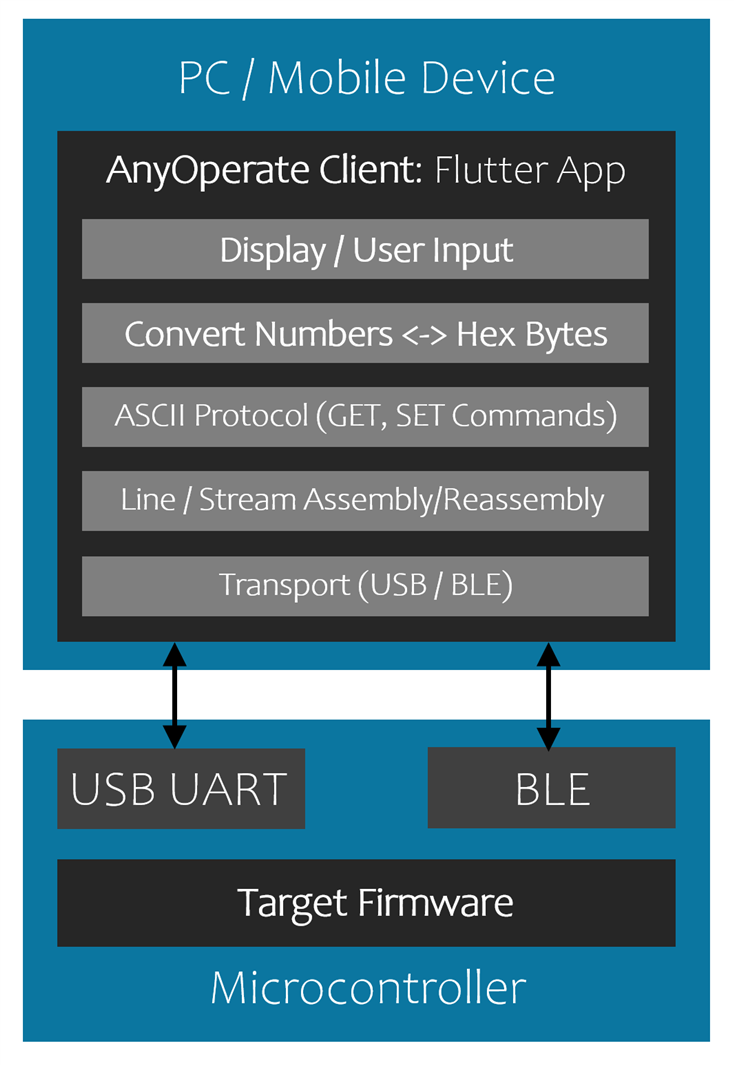

The diagram here shows what the app does internally. The app presents the user with a display of parameters and the user can edit them. Numbers are internally converted from user-friendly decimal values to more microcontroller-friendly hex bytes. Commands are created, such as GET temperature or SET relay1=ON and then are streamed over USB Serial or Bluetooth LE to the target microcontroller device.
The microcontroller firmware (not discussed in any detail here) would need to be developed to accept and respond to GET and SET commands, but also to respond to LIST commands with the list of supported parameters that the microcontroller firmware is willing to allow the AnyOperate app to view or modify. For instance, the microcontroller might respond with temperature|Temperature (deg C)|float and relay1|Main Relay|string.

Block Diagram
The diagram here shows from the bottom-up, how the app functions. At the bottom, the serial data stream is of the format described above, in the Protocol Overview, but, since the actual transport method (e.g. BLE) might not support large volumes of content in one go, the protocol content is broken up into smaller fragments where needed. This is one reason why commands are sent with a special character such as $ at the beginning, and \n at the end.
The protocol transfers integers and floating point numbers as hexadecimal bytes (Big-endian order), which is ugly to use for an end user, hence a conversion is done between those bytes and a friendly decimal version, so that parameters can be nicely displayed and edited.

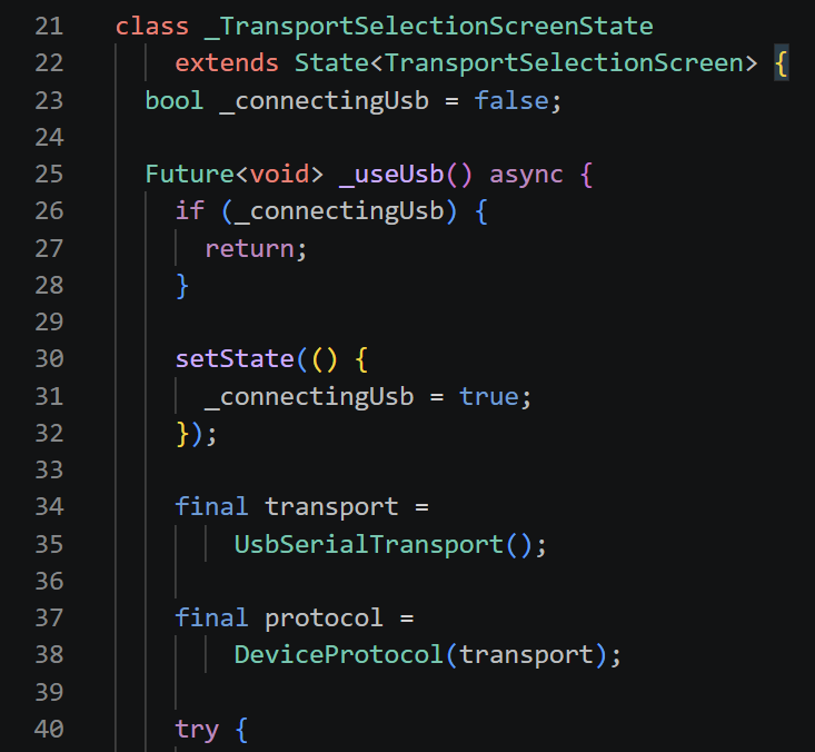

When the USB tile is pressed, if the variable _connectingUsb is null then the function _useUsb() will execute, and when the BLE tile is pressed (not shown in the screenshot above but it is in the code), the function _useBluetooth() will execute.
Focusing just on USB for now, we can now look through the rest of the class and see that _useUsb function begins with:
Future<void> _useUsb() async {

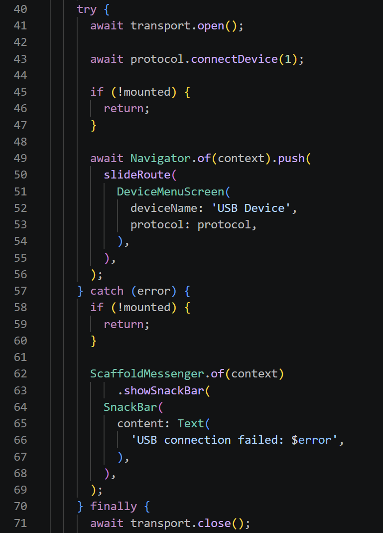

Another concept worth being aware of is try..catch..finally. At a high level, as the code in the try block of code runs, if any part of that results in an error (known as throwing an exception, since code can literally include things like: throw Exception(‘no response!’)) then the remainder of the code in the try block is aborted, and the code in the catch block runs instead. The code in the finally block runs regardless of if an exception occurred or not.
The code screenshot below shows part of a try..catch..finally sequence in the _useUsb function. The open and connectDevice functions will execute in sequence, but if they internally suspend for a length of time, then the remainder of the application will continue to run even though the async function is paused.
The if (!mounted) part of code is used a lot after await statements; while the function was suspended waiting for the Future, the screen's State might have been removed from the widget tree (say if the user navigated away while a device was still connecting) and then it could be necessary to abort running the remainder of the function, instead of trying to interact with a screen that no longer exists.
Navigator Stack
The bit of code starting with await Navigator.of(context).push is used to insert a route into the stack of screens (see the earlier blog for an explanation of this). In this code, slideRoute happens to be a template that adds a sliding animation to the transition, that part is not essential.

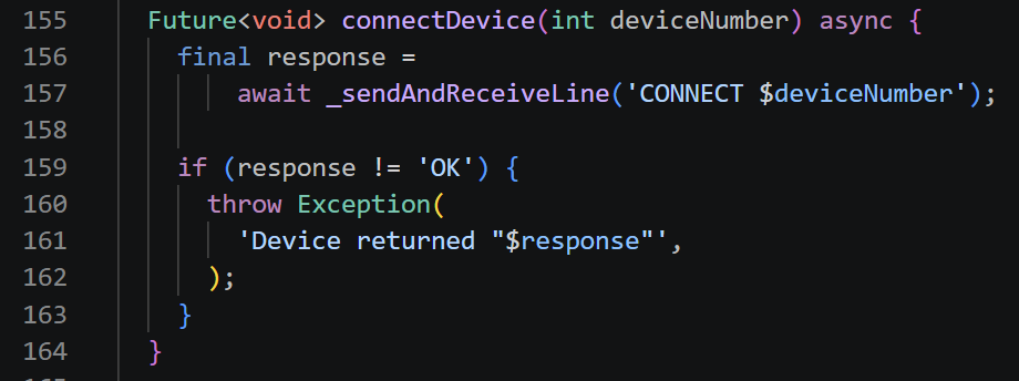

Skipping to the sixth arrow in the sequence diagram, we already saw in the code earlier that the code issues await protocol.connectDevice(1) and since this is protocol related, the class will most likely be in the lib/services folder. The relevant function in the DeviceProtocol class is shown below.
The protocol can be recognised from the string on line 157; the text “CONNECT 1” will ultimately be sent to the microcontroller, wrapped with $ and \n.

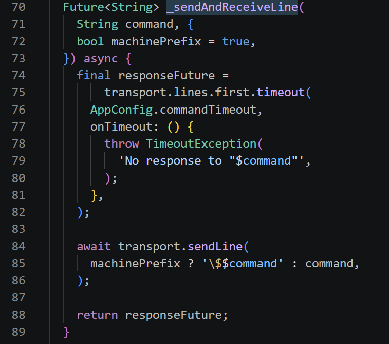

The next function that executes, _sendAndReceiveLine, has an unusual line transport.lines.first.timeout, and if you explore the code, you’ll see that transport references an object of type UsbSerialTransport.

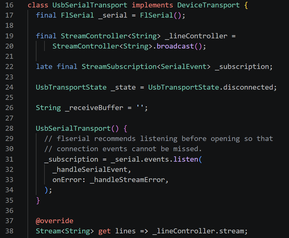

The UsbSerialTransport class contains this interesting line of code:
This is a Dart way of specifying how a function can be used to retrieve or update (get or set!) a local variable. The code line can be interpreted as follows: Create a getter called lines, whose sole purpose is to return the local variable (an object in this case) _lineController.stream, and that will be an object of type Stream<string>.
So, whenever you wanted to obtain that object, you’d type something like:
Stream<String> responseStream = transport.lines;
Setters are a similar thing used to assign values/objects to variables belonging to some class.

A Stream<String> is like a pipe that passes multiple strings over time! One way to create that and feed strings into the pipe is by creating a StreamController object in the code, and then using its add function. On the receiving end of the pipe, you can pick off individual strings using Future<String> objects.
If you look at the _sendAndReceiveLine function in the screenshot further above, the transport.lines.first.timeout() function call now makes more sense. The return value is a Future<String> object, and first is a core function of Stream, that provides the object at the head of the pipe. A timeout is used so that an exception can be thrown if nothing arrives for ages (currently configured to be 1 sec; the microcontroller must respond in that time).
The code continues running (with just the promise that a Future<String> will eventually become available) and then the await transport.sendLine is used to send the text over the USB Serial connection (and suspend here and let other parts of the app continue running).
Next, the code suspends and waits at return responseFuture, until the promise is fulfilled and the head of the pipe provides the content for the Future<String> object to be returned. That, of course, occurs after the microcontroller gets around to building up a response to the “$CONNECT 1\n” request that was sent, and sends it over USB serial.

The application pubspec.yaml file (see pubspec documentation) was modified to specify a dependency:
flserial: ^0.7.3
The flserial library allows a developer to register callbacks that run whenever serial events occur. The flserial library happens to implement a Stream internally too. Instead of using first to pick off just the first item from the head of the serial data/events from that internal pipe, you can make an indefinite connection or subscription (to continuously receive serial events/data) by using the FlSerial object’s events.listen() function and register callbacks that will repeatedly get called as the pipe sees content arrive.
Incidentally, sending data via USB serial is easy; a write() function is available with the FlSerial object.
Line Reassembly and Feeding the Stream
If you look further at the source code file, you’ll see that the receiving data callback eventually executes _handleIncomingBytes, which appends whatever arrives to _receiveBuffer, until a \n character is observed. The text up to that is placed into a line variable, and then the add function mentioned previously, is used to feed the completed response text into the stream that was using the stream controller that we saw earlier, _lineController, which was a member field of UsbSerialTransport.
