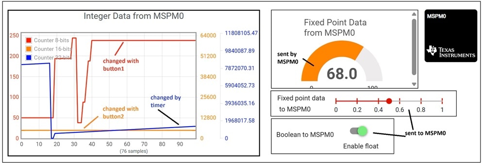

In this demo, when you click on the green button on the PC GUI, a JSON message is sent to your EasyL1105 over UART. This will result that the function below will be called. Your firmware state is kept in sync with the GUI controls.

The other way around, if you click a button on the EasyL1105, the red or orange line (depending on which button you pressed) in the PC GUI graph will change.

The readme file in the project has a link to the PC GUI. It runs in your browser, and uses TI Cloud Agent to connect to your board's COM port. If you don't have the agent installed, the GUI will ask you to do that.
Alternatively, you can connect a terminal with 9600 8N1, and see the JSON data coming from the EasyL1105. If you're a hero, you can even send a JSON package to it, and see if you can make it call one of the two callbacks ...

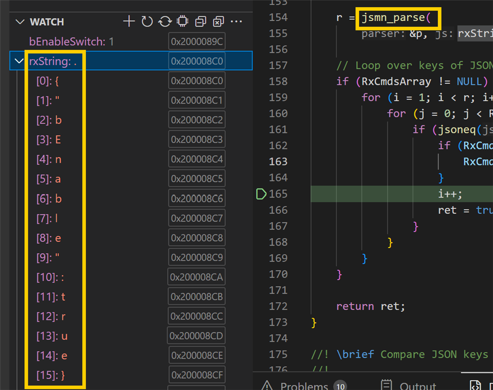

    A simple c program, run on my windows laptop, that sends JSON to the EasyL1105:
    // Serial library
    #include "serialib.h"
    #include <unistd.h>
    #include <stdio.h>
    #define SERIAL_PORT "\\\\.\\COM23"
    int main()
        serialib serial;
        char errorOpening = serial.openDevice(SERIAL_PORT, 9600);
        if (errorOpening!=1) return errorOpening;
        printf ("Successful connection to %s\n",SERIAL_PORT);
        // Create the string
        char buffer[18] = "{\"bEnable\":true}\n";
        serial.writeString(buffer);
        serial.closeDevice();
        return 0 ;
    I made the firmware break where the payload gets JSON parsed. All works as expected, and the callback for my bEnable data point will get executed.
