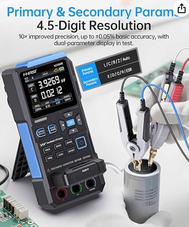

    Nice. Got a new meter, but I can't recommend it yet... Has quirks.

    scottiebabe 7 months ago in reply to Jan Cumps
    Yes, an LC1020E
    Physical design, UI, etc is great for the price, not so sure about measurement performance yet...

    I spent 250 €  on mine.
    That FNIRSI sells for 1/4th the price down here. Cheaper from Aliexpress, but I have to pay import duties for every package these days.

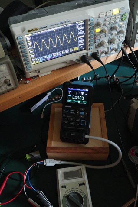

    looks like a nice meter, latest price seems to be €400+

    Kelvin probes - nice....

    The kelvin clips work great on small resistors. 100kHz mode is wonky.
