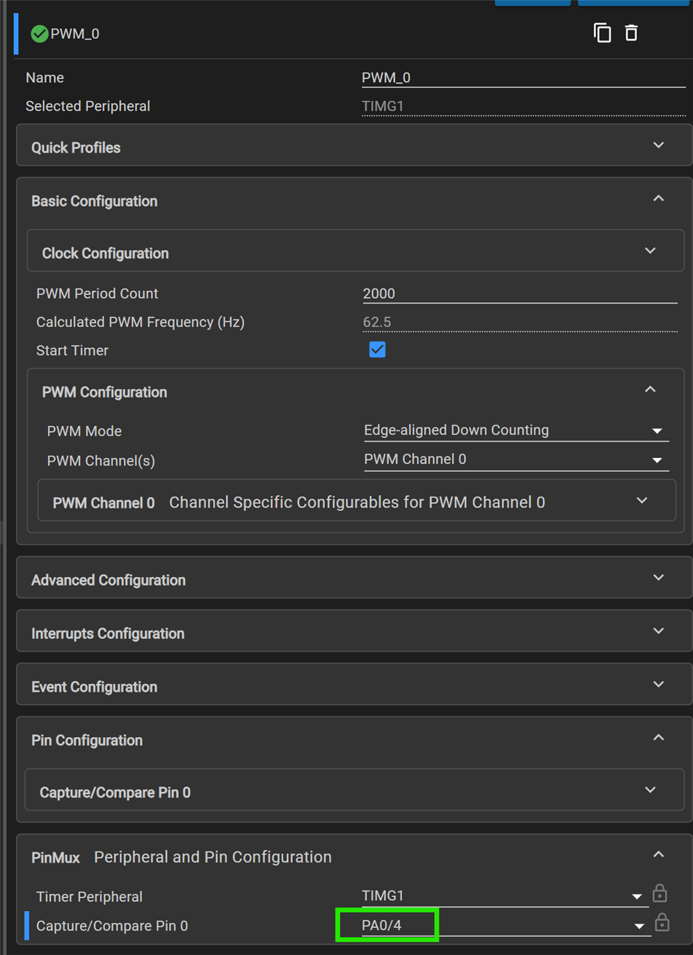

The Texas Instruments MSPM0 microcontroller has a few open drain IOs. TI calls them ODIO. In this post, I show that they can be controlled by a timer. More specific: one of the MSPM0 PWM peripherals will control the duty cycle of an open drain IO, and dim an LED.
What does this project do?
It dims an LED. But what it actually tries to showcase: the 5V tolerant open drain IOs can directly be controlled from a timer.

The circuit is simple. A red LED with a 330Ohm resistor in series. When PA0's gate is driven high by one of the controller PWM peripherals, the current in this circuit, and through PA0's channel, will be around 6.9 mA.

It's TI's pwm_led_driver example. An LED dimmer demo. But I routed the PWM output to open drain pin PA0.
In SysConfig:
I usually show some code highlights in this section. But I didn't change TI's example. So skipping it in this post.
