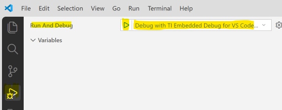

3: Debug
This step requires that you have a debugger, either on your LaunchPad, or a standalone XSD110
Select the VS Code Run and Debug button. There will be an entry for TI Embedded Debug.
The debugger will stop at the first executable line of code in main()
