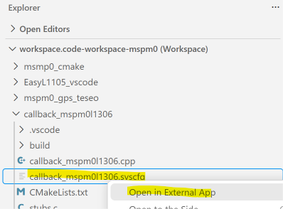

To let VS Code open a config file in SysConfig, there are two items to solve:
  • TI hasn't released a VS Code extension for SysConfig, but they have a standalone install.
  • VS Code can't call external editors by default, but the Open in External App extension can.
I installed both, and configured Open in External App: Open the extension, click the cog-wheel and select Settings.
I entered this:
"openInExternalApp.openMapper": [
            "extensionName": "syscfg",
            "apps": [
                    "title": "SysCfg Tool",
                    "shellCommand": "C:\\ti\\sysconfig_1.28.1\\nw\\nw.exe C:\\ti\\sysconfig_1.28.1\\app -s C:/ti/mspm0_sdk_2_11_00_07/.metadata/product.json ${file}"

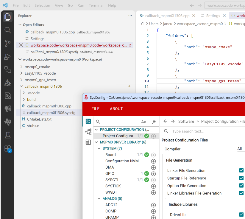

Then, when I right-click on a .syscfg file, I select the menu option Open in External App:
... and the file opens in the GUI. You can then change settings and save it.
No need to generate the files from the GUI. Our CMake script does that for us (if you followed blog 1 - 4 Slight smile)

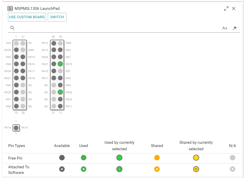

    Jan Cumps 2 months ago
    I hadn't seen this LaunchPad view before:
