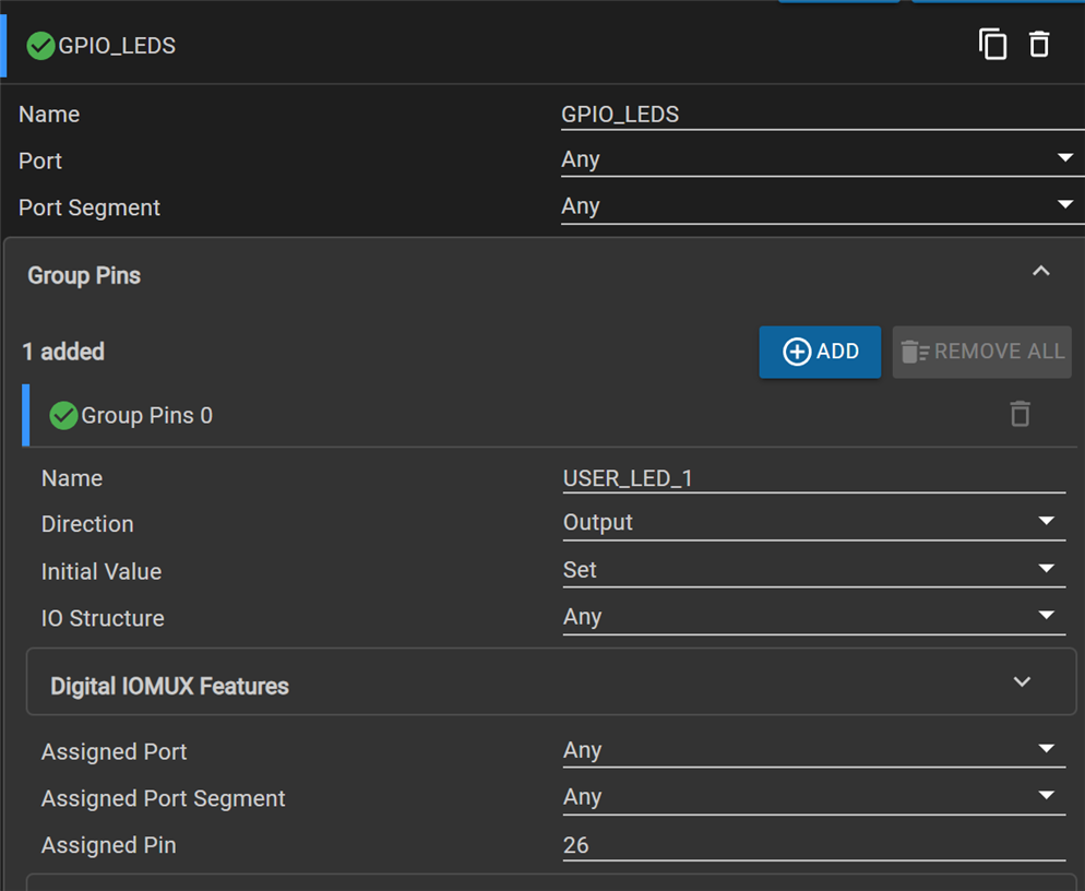

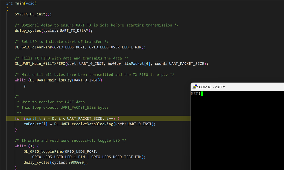

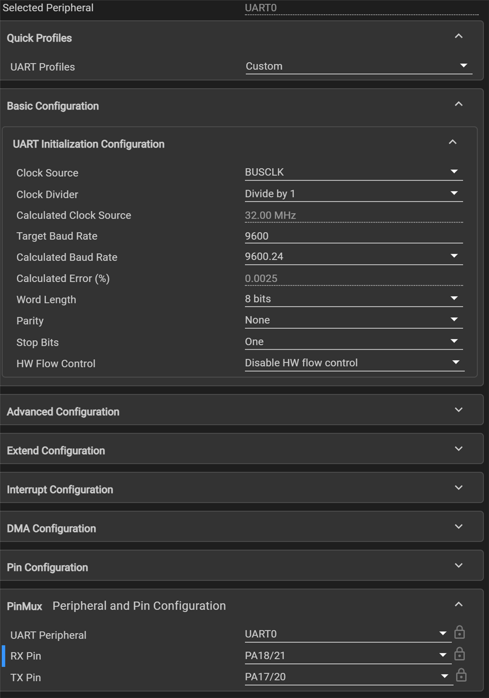

    First project that uses serial comms over the USB
    It's based on the example uart_rw_multibyte_fifo_poll
    I had to adapt controller, UART pins and LED pin. All via SysConfig:
