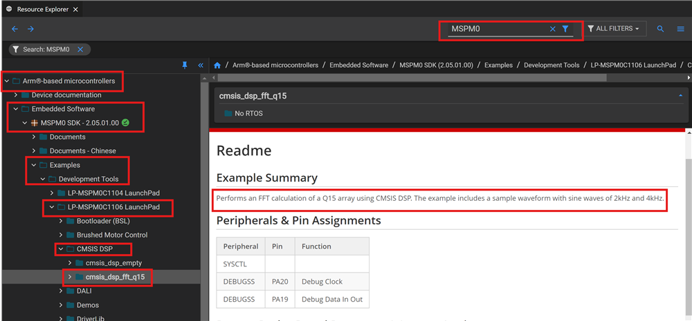

Find an example
The easiest way to find examples is from TI Resource Explorer. Either online, or from ccsstudio:

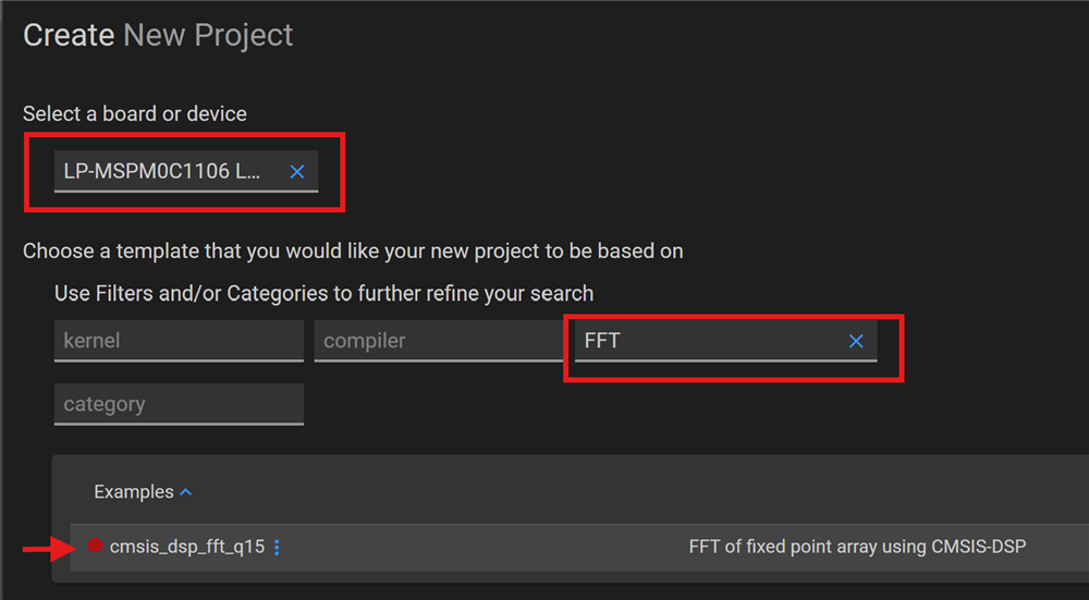

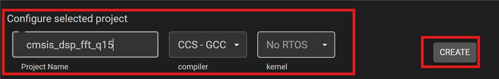

I used the ccstudio New Project wizard to create my own project. If you do this with a different toolset: all resources are available:

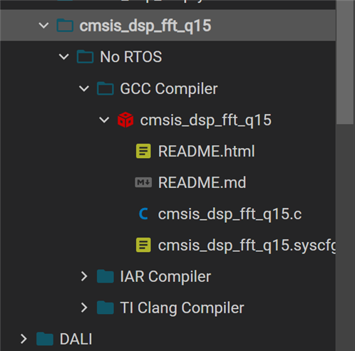

Import the project
The New project wizard does all the copying and VSCode project setup:

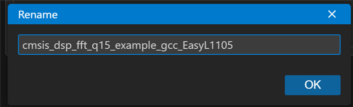

When you create this project, it will not be for our controller. Ignore that for the moment.
You 'll see that, after creation, the project name contains to the LaunchPad name. Right click on the generated project, and give it a good name

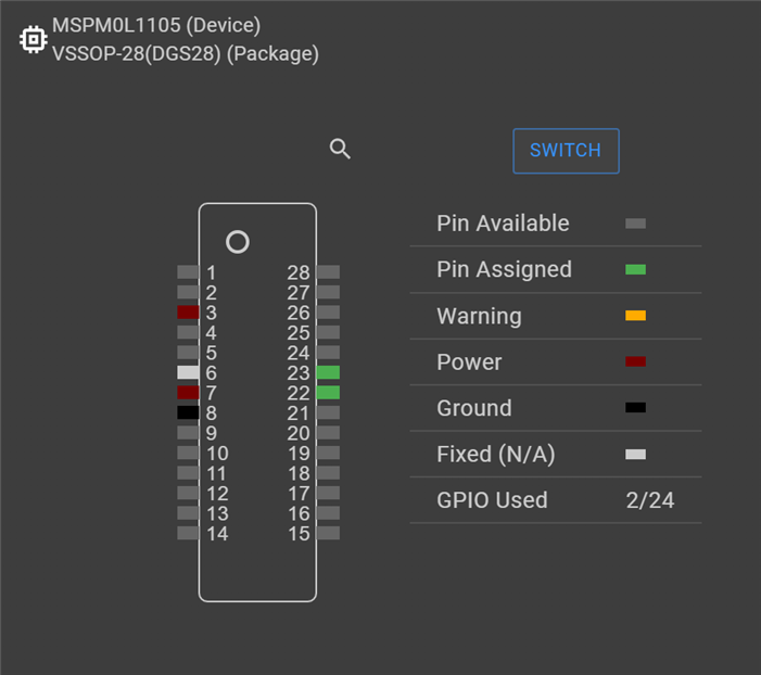

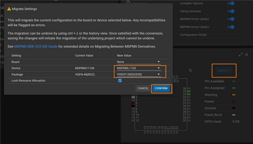

In ccstudio, the SysConfig screen opens automatically. When you do this with SysConfig standalone, load the .syscfg file.
Press the SWITCH button to port it to our controller.
  • device: MSPM0L1105
  • package: VSSOP-28(DGS28)
Almost finished. This is now ready for build and test

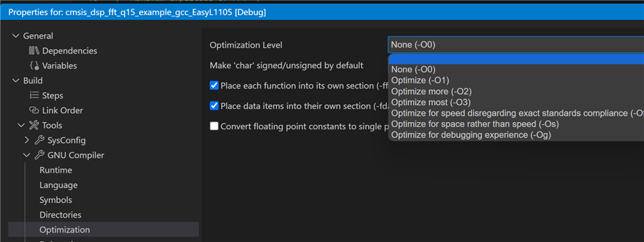

This example doesn't do anything visible from the outside. It's supposed to be run from a debugger. Before doing that, I changed the optimisation setting to 0.
