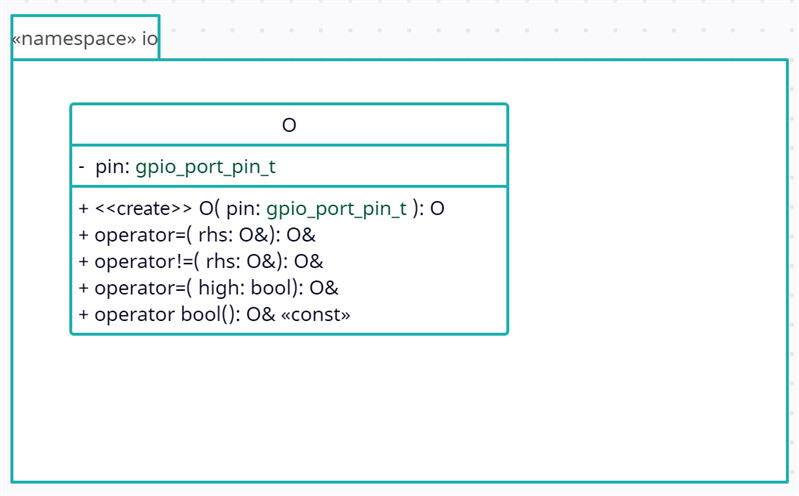

For  simplicity, I'm creating one class: an output pin class called io::O. It can drive a pin high and low. You assign a pin at creation time. You can drive it by assigning true or false to it:

Class O
header: O.h
#ifndef O_H_
#define O_H_
extern "C" {
#include "r_gpio_rx_if.h"
namespace io {
typedef gpio_port_pin_t pin_t;
class O {
public:
	O(pin_t pin);
	virtual ~O();
	O &operator= (O &rhs);
    O &operator!= (O &rhs);
	O &operator= (bool high);
	operator bool() const;
protected:
  pin_t pin;
} // namespace io
#endif /* O_H_ */

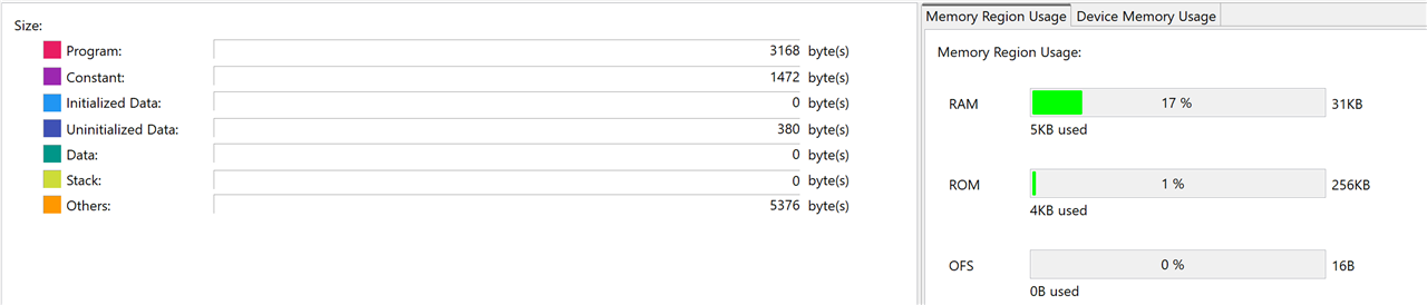

    Jan Cumps over 3 years ago in reply to Jan Cumps
    By moving the class declarfations from main to global,, the memory use redused "a lot"
    I don't know why yet ...

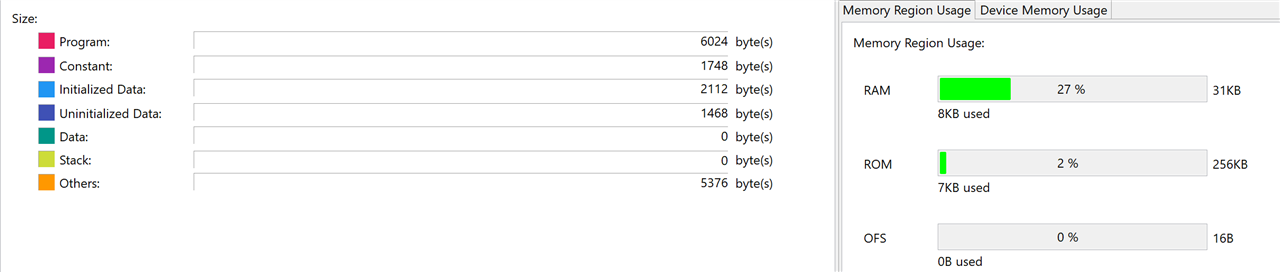

    For the fans, memory usage
    CPP:
    C:
