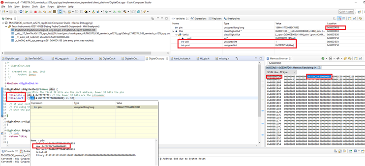

Here is how my DigitalOut class members looks like at the end of the constructor execution (for LED1, where the port is 0xFFF7BC34 and the pin 1 is 1).
at the time this variable declaration is executed, just after parsing the port and pin from PinName...
DigitalOut led( LED1 );

    Jan Cumps over 6 years ago in reply to fmilburn
    The photo below is not very spectacular, but it's the first gpio pin that's toggled by the ported DigitalOut object.
    Code:
      led = 0; // led off
      led = !led; // led toggle
    The last line in particular is interesting.
    This will call both the read and write operators of the object.
    First the read operator (right side of the equation) to read current value (0)
    Then it will invert that value ( !0 -> 1 )
    Then it assigns that to the left sie of the equation, resulting in writing a 1 to the pin.
    Code of the read and write operations in the DigitalOut class source:
    the gioxxx() functions are the implementation APIs of the Hercules controller I'm using. This code is isolated from the rest of the port to keep device dependent sources in a unique separate directory.
    DigitalOut &DigitalOut::operator= (int value) {
      gioSetBit((gioPORT_t *)(this->port), this->pin, value);
      return *this;
    DigitalOut::operator int() {
      return gioGetBit((gioPORT_t *)(this->port), this->pin);
    When you assign an int to an object of this class (in this case the object led), the first method operator= gets called.
    When you put the object as a right side argument or as an int parameter in a function call, it will call the second method operator int().
